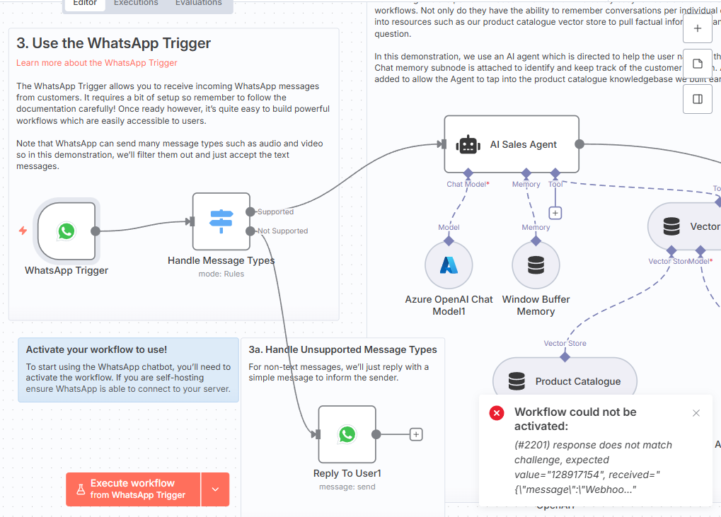

Lost in whatsapp trigger "response does not match challenge"
Starting with the Building Your First WhatsApp Chatbot | n8n workflow template workflow, I configured the WhatsApp OAuth account and WhatsApp account and the creds looks successfully tested.
As I try to activate the workflow the webhook verification process fail. I am surely missing a small piece of configuration somewhere.

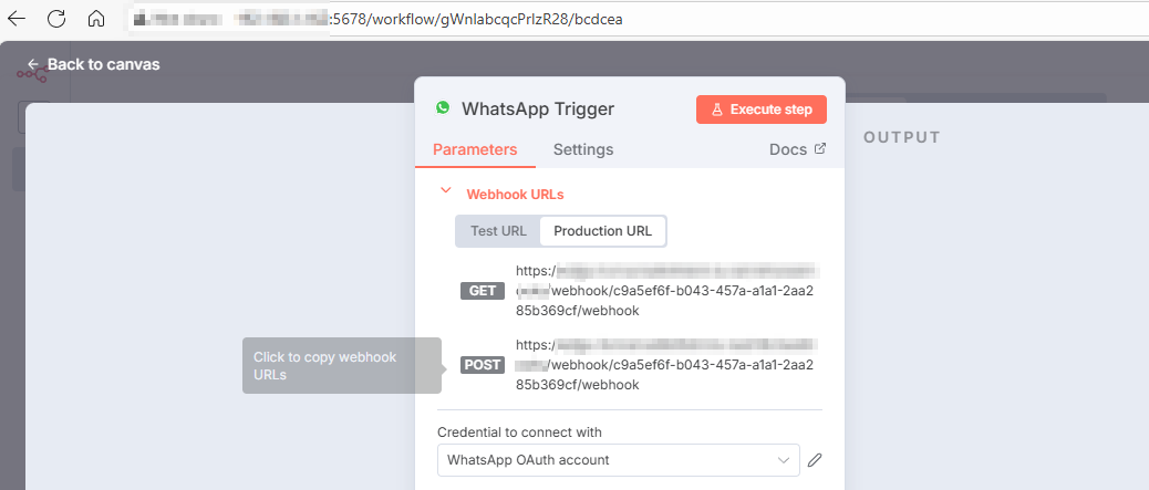

I have n8n locally as container and n8n is exposing the webhook via tailscale funnel, something like https://tailscale/path/webhook/c9a5ef6f-b043-457a-a1a1-2aa285b369cf/webhook. For clarity I have another telegram triggered workflow running, based on similar webhook mechanism.

Activation fails with:
Workflow could not be activated: (#2201*) response does not match challenge, expected value=“128917154”, received="{\“message\”:\“Webhoo…”*
The error in the screenshot correspond to the challenge passed in the request (I see it in my tailscale + nginx stack) coming from Meta to my n8n environment :

For completeness, the request I see from MEta is to the production url of the trigger.
it is the https://n8n.io/workflows/2465-building-your-first-whatsapp-chatbot/
