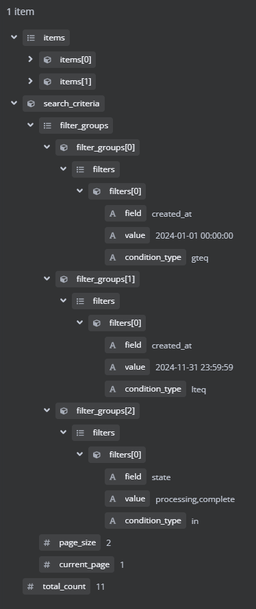

The output looks as follows:
pageSize: This is always equal to the number specified in the pageSize query parameter. In this case, it remains 2 regardless of currentPage.
currentPage: This is indeed the current (returned) page.
total_count: This is indeed the total number of available items. In this case, it’s 11.

Hopefully, I understand this question correctly. pageSize and currentPage are included in the query parameters. These, along with the other searchCriteria, are also included in the response (see the example earlier in this message).
total_count is only returned by the API and cannot be part of the query parameters.

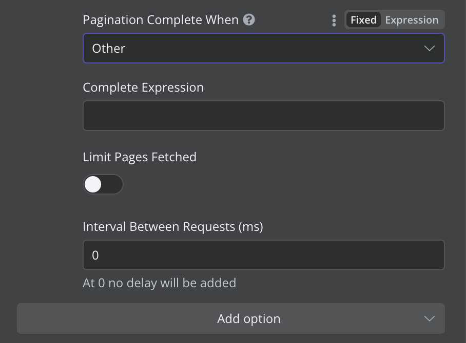

The currentPage is actually nested in your filter. It’s rather searchCriteria.currentPage. That is what I meant when mentioned “nested JSON”. Nested query parameters change during pagination might not work.
Also you need to tell HTTP Request node wheh to stop. In your last case you retrieved the very same page many times and the node “realised” the pagination is not working terminating it with the error.
You need to set the condition for pagination completion in the section shown below.
