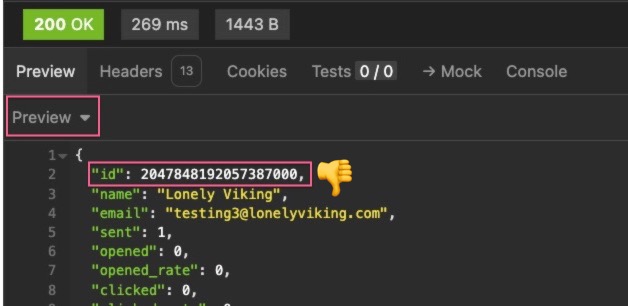

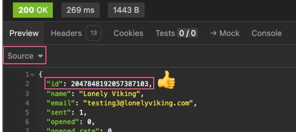

I am using the HTTP request node and when I create a user the response from from Mailerlite includes and ID that I use later to add that subscriber to a group, but the ID is not correct. The same happens if I specifically get a user by email. I am using the Mailerlite Classic API for this as the account is an old account.
Actual ID: 2047848192057387103
Returned ID: 2047848192057387000
If I do the same in Insomnia I notice something strange. The Visual Preview of the response is incorrect, but the Source is correct.
So it seems that N8N is returning the what Insomnia does as a Preview rather than the Source?
