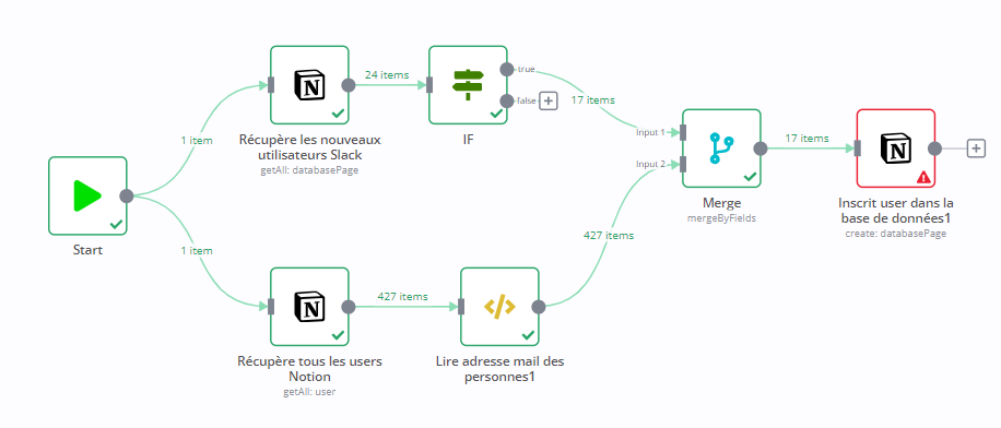

Do you know why there can only be one branch of Notion nodes running at the same time ?
I want to maintain a database of the Notion users of my workspace with their email address and their Notion ID.
I have a workflow that relies on two Notion nodes :
1 - getall : user to retrieve all the IDs
2 - getall : databasePage where I get the new users to add to the main database with their email address
Ideally I would like to create a new database item including the ID of the first node and the email address of the second node. But as soon as I run a node, n8n forget the output of the other node.
Do you know how I can overcome this limitation ?
Many thanks for your help :folded_hands:
Hey @Benjamin_Chevalier,
Welcome to the community :raised_hands:
It sounds like what you might want is the merge node that will let you merge the items from 2 nodes and work with the output as needed, Something like the below might be what you are after.
Many thanks Jon, this is clever and it could do the trick. :muscle:
I will try it and keep you updated !
Have a great day !
The “merge” node works well for my use case.
I struggled at some point but I found the answer here :
Thank you again @Jon :folded_hands::folded_hands::folded_hands: !
