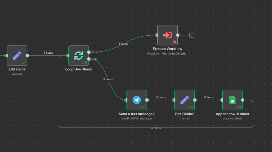

As far as i understand from your question, n8n already does what you want
Most of the nodes will finish their queues before moving to the next node.
If that is not the case for you, you can always loop through the items and then connect your next node to the “Done” part of the Loop.
Also, i would separate the concerns and create a workflow for each. The workflow you described, lets say it is the Generation Workflow is a good example, it has a distinct job to generate and upload. If you want to add a new feature to the flow, like an AI Editor for your pdfs, i think it is always better to create a new workflow Editor and call it at the end of your Generator workflow. You can do this with an Execute Sub-Workflow node.
Hope this helps with your question.

Yes, in this set up Google Drive Node will upload all before moving in the next node.
You can use an Execute Sub-Workflow node after the upload to call the python magic workflow.
I just made myself a download version, the google sheet has 12 urls, feeds in to drive node, drive downloads all 12 and then moves on to the next node.
There is always an option to use Wait node with a webhook re-activation. This is when the wait node will wait until you call an execution.resumeUrl
