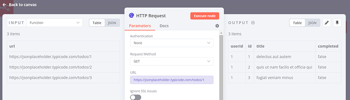

I have a list of URLs and I want to make an HTTP request on each URL to then use the results in other areas of my workflow. Is that something that N8N can handle? If so, how would I go about it?
Hi @kenepas,
that can be easily done using the HTTP Request node.
I created a sample workflow using an expression to bind the incoming urls.

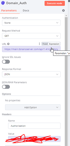

Thank You for your reply my workflow has admin password and api key the first to nodes are doing the auth for api key and in the function I have added the websites the Last node just copies the auth token from the Request_For_Authkey and calls the url if I use one url it works but as soon as I add the second one it fails.
This the last HTTP has in the header I am passing the API key in the header
So in my case I have to cal the API first to obtain special username then second http will add the OTP with the special username and give me the Auth Token third Http is using the Auth token to get the data but I have multiple url with different data to be pulled so that is why I was trying to use the function it works with one url but if I add the second one it falis.

Ok good. This is hard for me to debug since i cannot see your workflow. Can you make screeshots from the expressions that you are using to set the headers? Even better would be if you post your workflow with all sensitive information replaced with dummy values.
Dose this help
Yes this helps, thanks a lot. I think i see the problem. The expression you are using for your header value should be this:
The $item(0) at the beginning will make sure to always use the first response from Request_For_AuthKey, also for your 2nd and 3rd url. Internally n8n will use something we call a runIndex, so for your second url it will try to load the second Request_For_AuthKey, which does not exist.
So you workflow should look like this.
Does this work for you?
