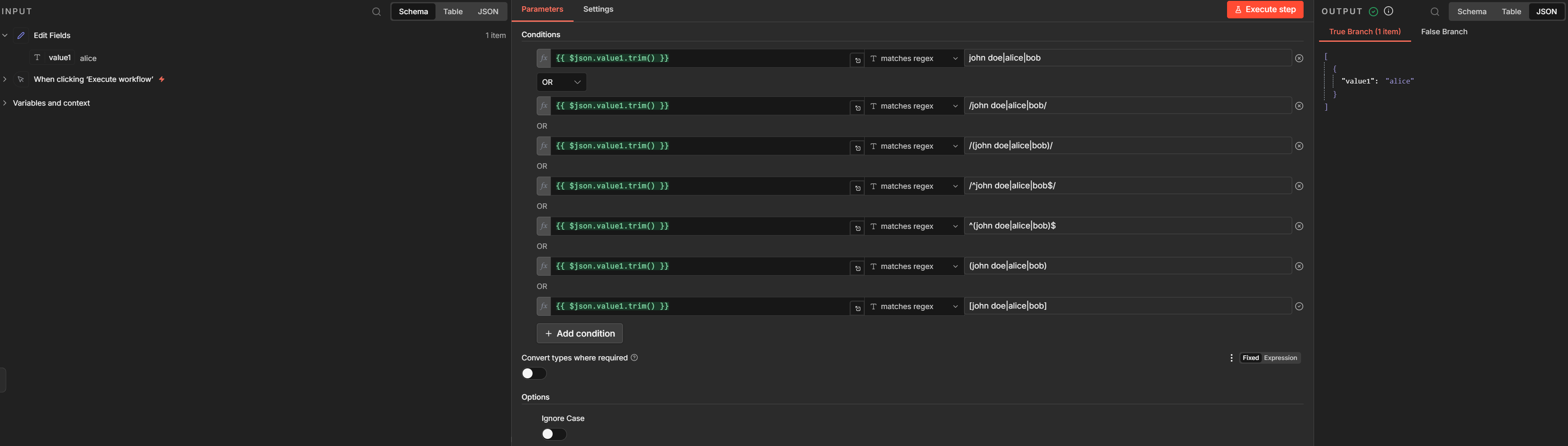

Thanks both.

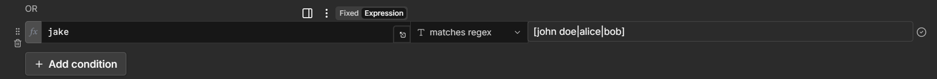

Using square brackets make it work:

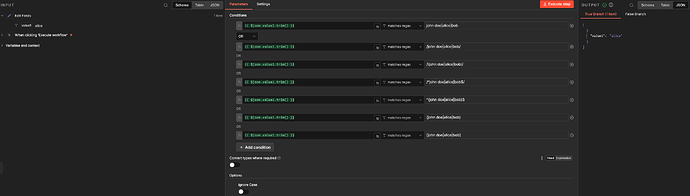

@Benjamin_Behrens see screenshot above, /abc|def/ doesn’t work either.
I think your comment about adding a /i flag is also worth providing a better documentation on n8n regexes, since there’s also a node option “Ignore case”: which flags are accepted by n8n regexes? Which have precedence over node options? Why are square brackets necessary when they are not in regex101 with flavor Javascript? etc.

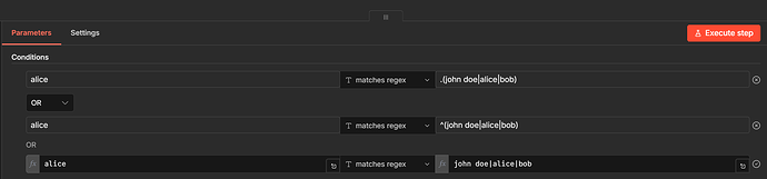

False flag @tamy.santos , the square brackets (I think they are to define character sets) are not a solution:

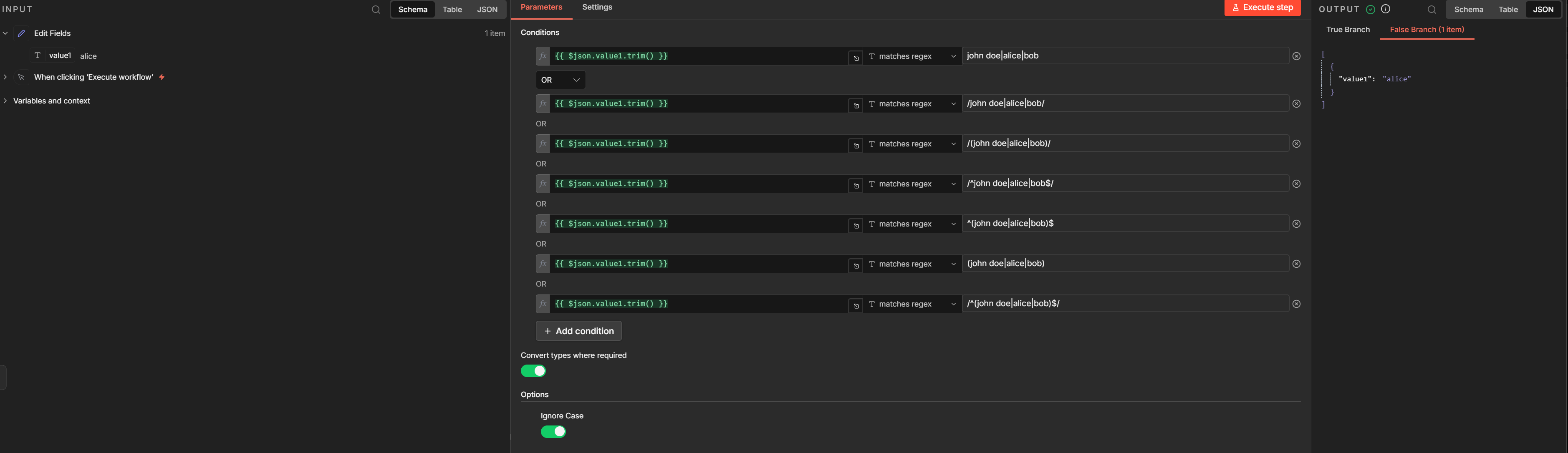

@jb8n

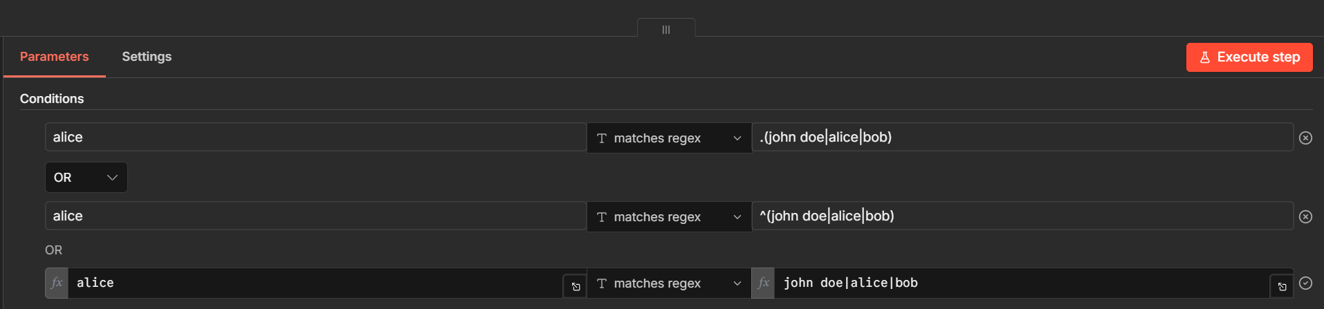

In regex, square brackets defines a character class, so it matches individual characters, not full alternatives like john doe|alice|bob. If you want alternation, I’d use parentheses instead, for example ^(john doe|alice|bob) if you want the string to start with one of those values, or .(john doe|alice|bob). if you want to match them anywhere in the text. So thanks for calling that out — the brackets would definitely change the meaning of the pattern.
Thanks, I tried your suggestions, but adding parentheses doesn’t lead to the expected behavior either:
Does this simple IF node make the regex match pass on your instance?
Thanks!
