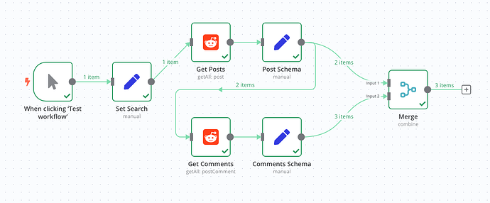

My goal is to pull an X number of posts with their respective comments from Reddit and join them in a way that each post contains an array with its comments underneath.
Here’s what I’ve done.
Process:
  • I’m pulling the posts from Reddit (with post_name being the main identifier)
  • I’m pulling the comments for these posts from Reddit (with the parent_ID and link_ID) in this case the connection with the post.
  • I’m running this through a merge process - with combine by matching fields as the operation. As input 1 I have posts (identified by post_name). As input 2, I have comments (identified by parent_id).
  • This generates merged out, but the result is not exactly how I want it.

Clearly, what I want to accomplish is a structure like:
Post 1
Comments:
  • comment 1
  • comment 2
Post 2
  • comment 3
  • comment 4
  • etc

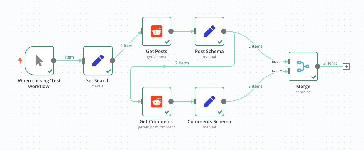

My flow looks like this at the moment. ChatGPT is useless. Does anyone have the right answer for this?
Thanks!
Hey @flyover137
The loop node sounds like what you’re looking for. Give this a try.
Thanks Jim, I’ll give this a shot as well. What would this look like if I wanted to capture sub-comments as well?
Like so:
  • Post
  • Comment
    • Subcomment
  • ** Sub-Subcomment
Thanks for your reply and Merry Xmas.
