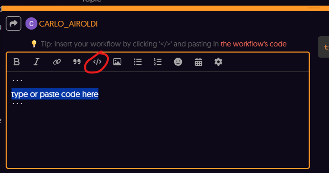

My apologies, but I don’t undestand what want me to do! What do you mean “upload into a code block”?
You can copy your n8n workflow, and paste it into a reply here. Then we can look at your actual flow.
