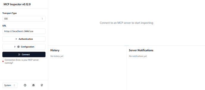

I would point to testing further with GitHub - modelcontextprotocol/inspector: Visual testing tool for MCP servers
As it seems mcp server maybe facing issue, it could also be an issue with the sse URL ie its hosted with railway, maybe try testing locally first rule out if it because of railway etc.
adding to watch, like to see the resolutions for this.

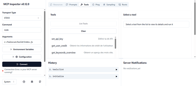

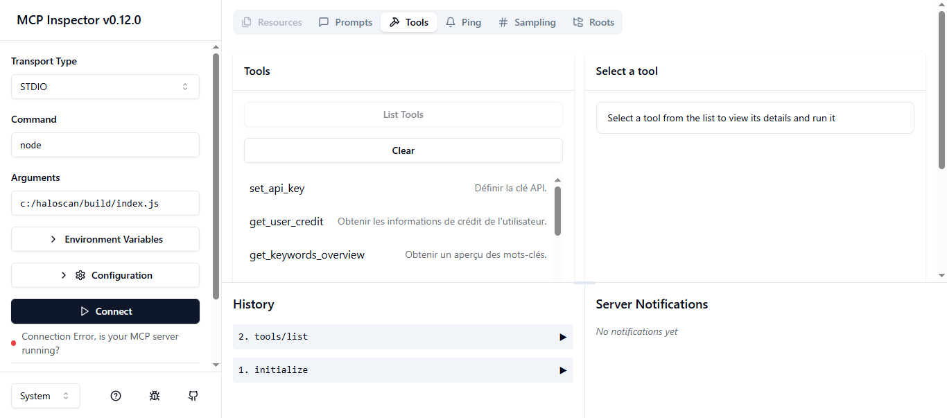

thanks for the response Samuel when i build my mcp server i create the stdio transport dor claude desktop and sse transport for n8n. The stdio transport work in n8n but locally my goal is to use sse to get tools in n8n
I have a similar problem and I think it has to do with the fact that the n8n MCP client uses SSE as the transport standard, but this mechanism has been deprecated in the latest version of MCP. This Github issue is related: https://github.com/n8n-io/n8n/issues/16240.
