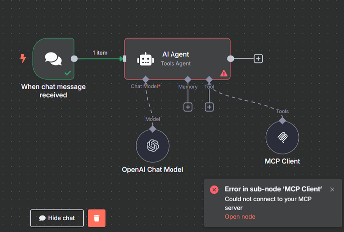

I’m experiencing an issue with the MCP (Model Context Protocol) server functionality in my n8n installation. I’ve created a simple MCP server with a calculator tool, but it doesn’t work at all - it’s as if the MCP functionality isn’t present. When attempting to run a workflow that uses the MCP Client node, I receive a connection error.
When running the workflow in n8n: Error in sub-node ‘MCP Client’: Could not connect to your MCP server

The workflow fails with the error message: “Error in sub-node ‘MCP Client’: Could not connect to your MCP server”

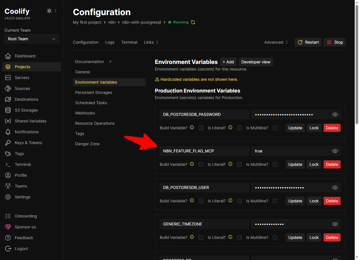

Thank you for your advice. I added that variable in coolify.:
But unfortunately it still doesn’t work:
