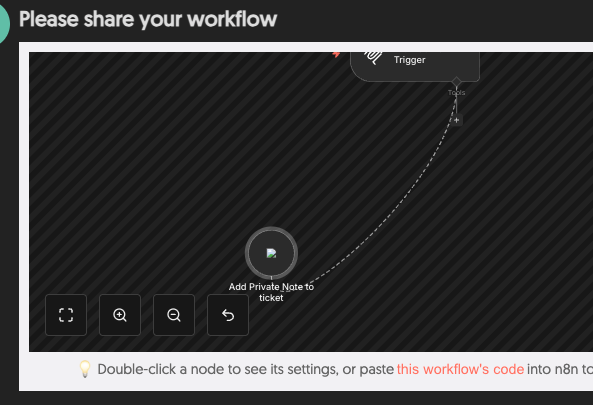

After working perfectly for a few months, out of the blue my MCP server trigger just stopped working. As of March the 9th. I think i updated to n8n 2.10.3 the day before.
The MCP returns
{“error”:{“message”:“Bad request - please check your parameters”,“name”:“NodeApiError”}}
I also notice in my cloudflared container it is constantly showing the below info
2026-03-09T18:32:40Z ERR error=“stream 412453 canceled by remote with error code 0” connIndex=2 event=1 ingressRule=2 originService=http://n8n:5678
When I look at the MCP server trigger workflow for the same run it just says:
”None of your tools were used in this run. Try giving your tools clearer names and descriptions to help the AI “
Everything sent to the tool was correct and parameters were correct.
When it starts getting htis error, every call returns that from the MCP.
If i unpublish and publish the MCP workflow, it immediately starts working again.
Testing now how long till it stops working.
Its a fairly simple MCP server with multiple HTTP nodes attached to do different ticket actions.
