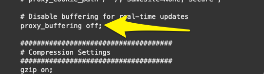

I have changed my nginx configuration, and now I’m down to this timeout error:
2025-04-16T12:22:33.540Z [info] [n8nSupergateway] Server transport closed unexpectedly, this is likely due to the process exiting early. If you are developing this MCP server you can add output to stderr (i.e. `console.error('...')` in JavaScript, `print('...', file=sys.stderr)` in python) and it will appear in this log.
2025-04-16T12:22:33.540Z [error] [n8nSupergateway] Server disconnected. For troubleshooting guidance, please visit our [debugging documentation](https://modelcontextprotocol.io/docs/tools/debugging)
==> /Users/ME/Library/Logs/Claude/mcp-server-n8nSupergateway.log <==
[supergateway] SSE → Stdio: {
  jsonrpc: '2.0',
  method: 'notifications/cancelled',
  params: {
    requestId: 0,
    reason: 'Error: MCP error -32001: Request timed out'
2025-04-16T12:22:33.556Z [n8nSupergateway] [info] Message from server: {"jsonrpc":"2.0","method":"notifications/cancelled","params":{"requestId":0,"reason":"Error: MCP error -32001: Request timed out"}}
The error as it was logged in nginx:
146.70.194.54 - - [16/Apr/2025:14:26:35 +0200] "POST /mcp/ultimate-mcp-server/messages?sessionId=78ed....c8a2 HTTP/1.1" 401 32 "-" "undici"
My nginx config:
# Add MCP protocol endpoint handling
    location /mcp/ {
      proxy_pass http://localhost:5678/mcp/;
      proxy_http_version 1.1;
      proxy_set_header Upgrade $http_upgrade;
      proxy_set_header Connection "upgrade";
      proxy_set_header Host $host;
      proxy_set_header X-Real-IP $remote_addr;
      proxy_set_header X-Forwarded-For $proxy_add_x_forwarded_for;
      proxy_set_header X-Forwarded-Proto $scheme;
      proxy_set_header Authorization $http_authorization;
      proxy_pass_header Authorization;
      # CORS headers for API
      add_header 'Access-Control-Allow-Origin' '*' always;
      add_header 'Access-Control-Allow-Methods' 'GET, POST, OPTIONS, PUT, DELETE' always;
      add_header 'Access-Control-Allow-Headers' 'DNT,User-Agent,X-Requested-With,If-Modified-Since,Cache-Control,Content-Type,Range,Authorization' always;
      add_header 'Access-Control-Expose-Headers' 'Content-Length,Content-Range,Authorization' always;
      # Handle preflight requests
      if ($request_method = 'OPTIONS') {
          add_header 'Access-Control-Allow-Origin' '*';
          add_header 'Access-Control-Allow-Methods' 'GET, POST, OPTIONS, PUT, DELETE';
          add_header 'Access-Control-Allow-Headers' 'DNT,User-Agent,X-Requested-With,If-Modified-Since,Cache-Control,Content-Type,Range,Authorization';
          add_header 'Access-Control-Max-Age' 1728000;
          add_header 'Content-Type' 'text/plain; charset=utf-8';
          add_header 'Content-Length' 0;
          return 204;
      # Longer timeouts for webhooks that might take time
      proxy_read_timeout 300s;
      proxy_send_timeout 300s;
I have the same issue. Did you find a solution?
Not yet but I’ll keep documenting my findings here.
I believe the next step is a thorough inspection of my entire nginx config.
(I didn’t find any official docs about it)
@Philippe_Greenleaf Care to try the following configuration and let me know if everything works well for you?
Note: there is no special treatment for any websocket or mcp paths. These can be added via dedictaed location blocks, but it seems that things work well as such.
LMK?
# Configuration for n8n
# Make sure to adjust: server_name, SSL certificate paths, and proxy_pass settings
# HTTP Server Block - Redirects all HTTP traffic to HTTPS
server {
    # Listen directives
    listen 80;                  # IPv4
    listen [::]:80;             # IPv6
    # Server identification
    server_name n8n.example.com;
    # Logging configuration
    access_log /var/log/nginx/n8n.access.log;
    error_log /var/log/nginx/n8n.error.log;
    # Redirect all HTTP traffic to HTTPS
    return 301 https://n8n.example.com$request_uri;
# HTTPS Server Block - Main configuration
server {
    # Basic Server Configuration
    # Listen directives
    listen 443 ssl http2;       # IPv4
    listen [::]:443 ssl http2;  # IPv6
    # SSL Configuration
    # Certificate paths - Ensure these paths are correct for your setup.
    # Typically managed by Certbot or another ACME client.
    ssl_certificate     /etc/letsencrypt/live/n8n.example.com/fullchain.pem;
    ssl_certificate_key /etc/letsencrypt/live/n8n.example.com/privkey.pem;
    # The following configuration can also be included from LetsEncrypt's config by uncommenting this line and commenting the other lines in this block:
    # include /etc/letsencrypt/options-ssl-nginx.conf;
    # SSL optimizations
    ssl_session_cache shared:le_nginx_SSL:10m;
    ssl_session_timeout 1440m;
    ssl_session_tickets off;
    ssl_protocols TLSv1.2 TLSv1.3;
    ssl_prefer_server_ciphers off;
    ssl_ciphers "ECDHE-ECDSA-AES128-GCM-SHA256:ECDHE-RSA-AES128-GCM-SHA256:ECDHE-ECDSA-AES256-GCM-SHA384:ECDHE-RSA-AES256-GCM-SHA384:ECDHE-ECDSA-CHACHA20-POLY1305:ECDHE-RSA-CHACHA20-POLY1305:DHE-RSA-AES128-GCM-SHA256:DHE-RSA-AES256-GCM-SHA384";
    ssl_dhparam /etc/letsencrypt/ssl-dhparams.pem;
    # OCSP Stapling - Uncomment after verifying SSL setup
    # ssl_stapling on;
    # ssl_stapling_verify on;
    # ssl_trusted_certificate /etc/letsencrypt/live/n8n.example.com/chain.pem;
    # resolver 8.8.8.8 8.8.4.4 valid=300s;
    # resolver_timeout 5s;
    # Security Headers
    # HSTS (HTTP Strict Transport Security) - Uncomment after verifying HTTPS works
    # add_header Strict-Transport-Security "max-age=63072000; includeSubDomains; preload" always;
    # Additional security headers could be added here
    # add_header X-Content-Type-Options "nosniff" always;
    # add_header X-Frame-Options "SAMEORIGIN" always;
    # add_header X-XSS-Protection "1; mode=block" always;
    # add_header Referrer-Policy "strict-origin-when-cross-origin" always;
    # Rate Limiting - This should be added to the http{} block in main nginx.conf
    # limit_req_zone $binary_remote_addr zone=n8n_limit:10m rate=10r/s;
    # Proxy Configuration
    # Buffer sizes for handling large payloads
    client_max_body_size 100M;
    client_body_buffer_size 20M;
    proxy_buffer_size 128k;
    proxy_buffers 4 256k;
    proxy_busy_buffers_size 256k;
    # Timeouts
    proxy_connect_timeout 180s;
    # Proxy headers
    # WebSocket and Server-Sent Events (SSE) support
    # Optional header handling - uncomment if needed
    # proxy_set_header Authorization $http_authorization;
    # proxy_pass_header Authorization;
    # proxy_cookie_path / "/; SameSite=None; Secure";

I had the same issue and the Solution that worked for me is in the code snipped provided by @Zohar .
proxy_buffering off;
I didn’t update all the other fields. The only thing I did was to add the buffering off field at the end of my n8n file that is within
/etc/nginx/sites-available
You may have it twice now :slight_smile:
