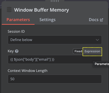

Hi @MM_MM
Thanks for posting here and welcome to the community! :cake:
I think it’s because you’re using an expression without having the expression mode turned on.
Could you give that a try?
Thanks, i had a blank value in a field being processed. Added an error trap and fixed it :+1:
