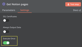

I can see that you have Supabase node preceding HTTP Request. Does it return more than one item? If so your HTTP Request will run many more unnecessary repeated paginations. You might want to set HTTP Request node to run only once.
