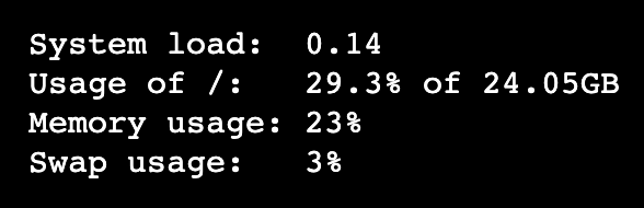

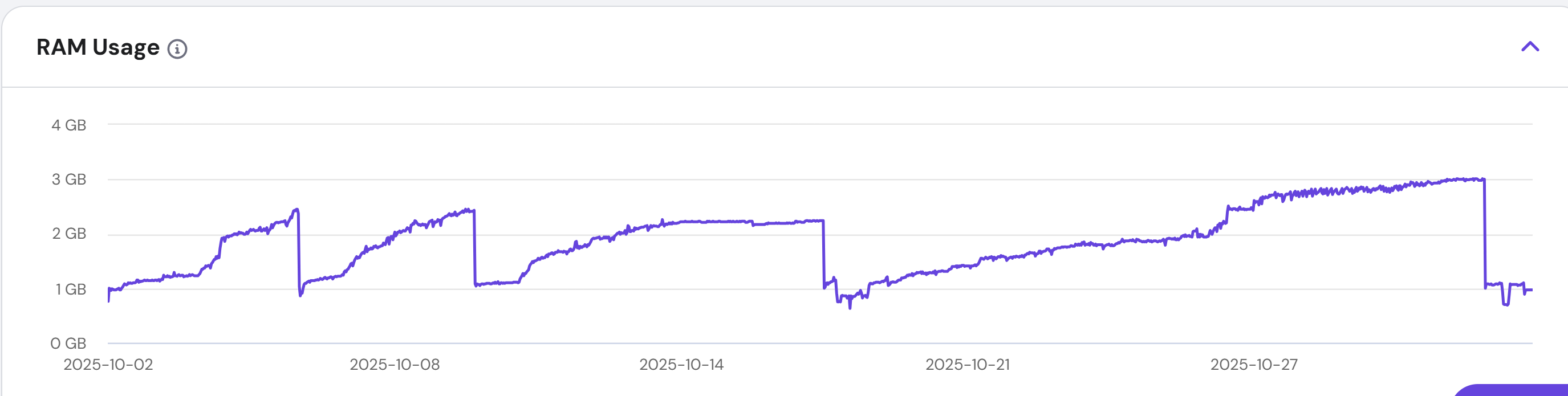

I’m not sure if the new updates have memory leaks or became memory intensive for some reason, but all my n8n instances have been having problems.
I’ve upgraded RAM to 2GB and added swap (2-4GB), but it was still having issues until I restarted it and quickly turned off all the workflows. Then it didn’t shut down that time.
I will say, n8n was able to handle more and was super reliable before the recent updates with folders, evaluations, etc.

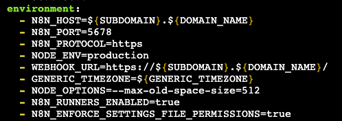

This is my config:
I added those last 3 lines when I started having issues. It helped a little.

One thing to double-check: it looks like you’re setting NODE_OPTIONS=--max-old-space-size=512. That flag actually limits the memory available to Node.js to just 512 MB. Unless this was intentional, I’d recommend either removing it or increasing the value significantly to avoid unnecessary memory constraints.

More info:
Stats with all workflows off for 1.97.1 (2 GB Memory / 1 AMD vCPU / 25 GB Disk)
lmk if I can provide anything else to help identify the problem
Also, can I safely revert back to an older n8n version? I need those production instances for Monday :confused:
Maybe it’s the stats causing this..?

I’m also noticing memory issues in some n8n instances with an AI agent, seems like it’s an n8n memory leak..
Need I say more? This is my workflow running on Hostinger n8n setup. Half on version 116 then I downgraded to 114 thinking that was the problem. I am going to make a cron to take docker down and up every night to solve for now. The workflow is just an AI agent with all the google tools hooked up. As you can see doing a docker stop and start releases the memory.
What I can’t understand is why others are not seeing this. When the memory gets high the workflow locks on and will not turn off even when the workflow is deactivated and can’t be turned off no matter what. The only solution I have found is to export all the workflows to json and reload in a fresh instance of n8n and then I have to hook up about 20 credentials. Such a pain.
