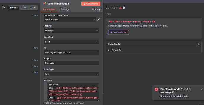

Hi, i have an issue with merge append module. Before it I use switch module, so only one input will execute. Then I want to append them together.
If the 1. input is not empty and only the 2 is empty the module will execute without an error, but when data arrives only in 2. input then there is an error.
error:
Paired item references non-existent branch
Item 0 in node Merge references a branch that doesn’t exist.

I already resolved it, there is no need to put merge node so i pluged them both into the last gmail node and it is working.
