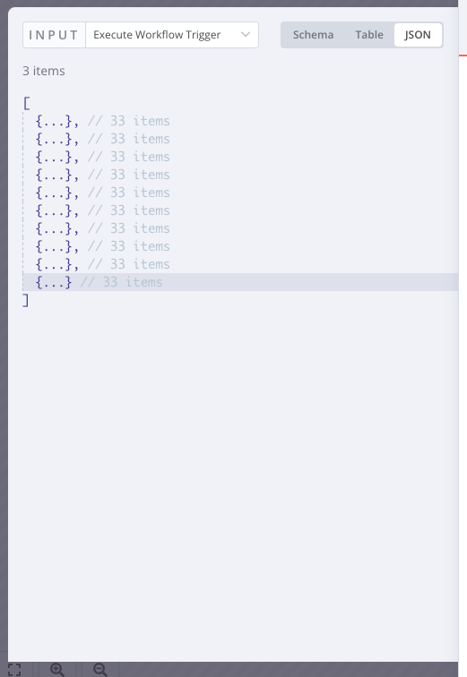

Actually, the execution shows 3 items only in the green lines when there are actually 23. I think this has to do with the problem. Also noted that as the JSON gets big, the interface started to hide it until you click to show it. Might be also related.

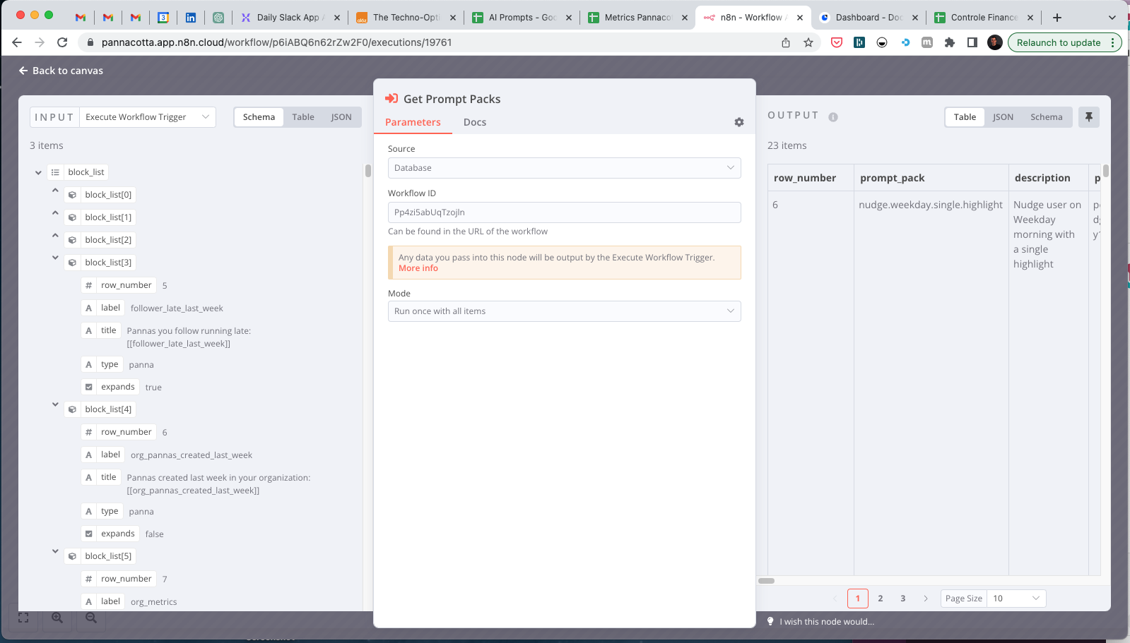

The input actually has 23, but only 3 are showing. Even though, if I collapse one by one in the JSON view I only see 9, it is still more than 3. See picture:
As n8n got lost in the number of items, the merge node in this WF also did, because the merge criteria was position. That’s why our customer’s data got mixed!
