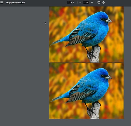

Send a variable number of images to Stirling API as formData and merge them to a single PDF.
I somehow had managed to achieve the first part (sending the data), but never managed to convert the response into a working PDF file.
grafik
What finally worked, was setting the encoding to “arraybuffer” and encoding the response to base64…
