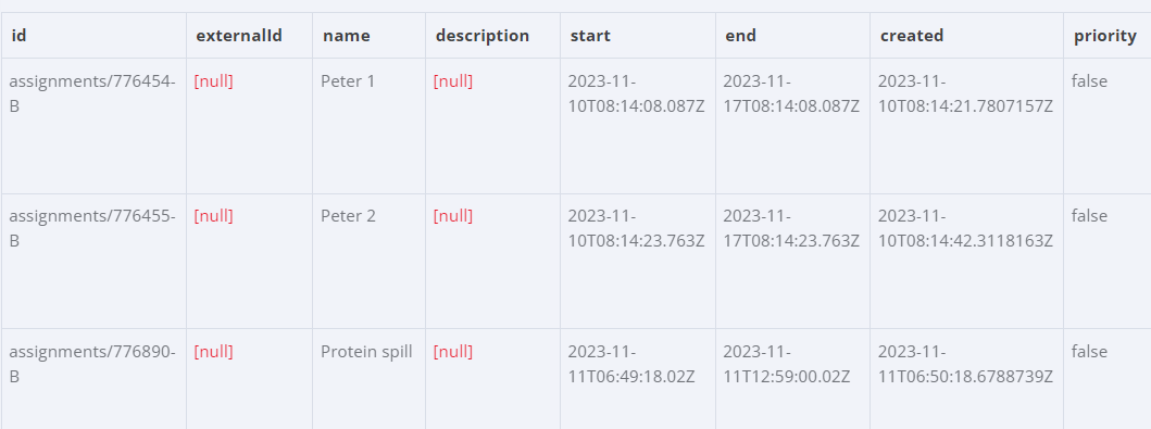

the current output of the list node (Sample Below )
The output of the GetLastMexWO is below
The output of my merge is
What i wanted.
I wanted to add the 2 columns incrementedWorkOrderID and incrementedWorkOrderNumber to the end of each row as shown above. So the merge multiplex kind of did the trick.
But I was trying to find a way that instead of the incrementedWorkOrderID and incrementedWorkOrderNumber being duplicated for each row, that it would take the input numbers being the first number shown on the top row (21264 and 22065) and increase it by 1 for each additional row as required.
Final Plan.
I was then going to try split out the rows again and post them to the api to receive the final reply with the additional processed fields before reposting the final values. I believe to do this i need to use loop but i will tackle that when i get to that point.
