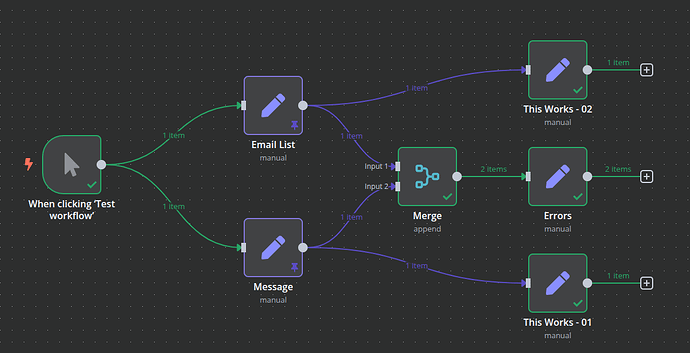

Setup:
1, The output from two Edit Set nodes are fed into a Merge node set to Append.
2. The Merge node flows to an Edit Set node.

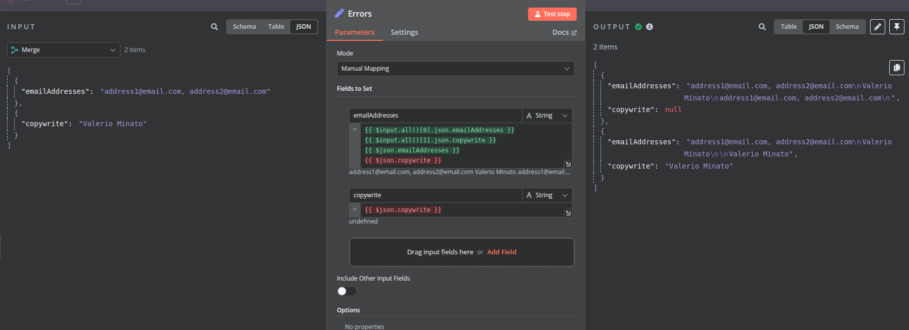

  1. If I manually enter the items from the Merge node, both items are recognized. i.e. {{ $input.all()[0].json.emailAddress }} and {{ $inputt.all()[1].json.copywrite }}
  2. If I drag & drop the items from the Merge node, only Input 1 is recognized. Input 2 is [undefined].
  3. I am expecting the output from the Edit Set node that is connected to the output of the Merge node to be:
“emailAddresses”: "[email protected], [email protected],
“copywrite”: “Valerio Minato”
Instead I get:
“emailAddresses”: “[email protected], [email protected]\nValerio Minato\[email protected], [email protected]\n”,
“copywrite”: null
“emailAddresses”: “[email protected], [email protected]\nValerio Minato\n\nValerio Minato”,
The error is: [undefined]
Image of workflow:
Image of Edit Set node after the Merge node:

See the images above.

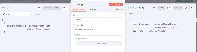

@HenryPuppet You should set the parameters as blew:
If this help you solve this issue,please mark it as a solution.
Alex,
Thank you. This gives me my expected output! I need to do some research into the Merge node though, I don’t understand why this works.
Thank you for taking the time to help me. I will mark this as solved. :hugs:
