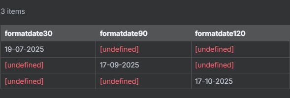

Hi. I have an issue with the Merge node output. I am trying to create a contracts expiry reminder and have three branches of 30, 90 and 120 days going in to the Merge node. The all produce results and I Append them in the Merge node. But 90 days and 120 days are later unusuable as the Filter node sees them as undefined (although they have value coming out). It seems the problem is in the table outout of the Merge node. Here pic:

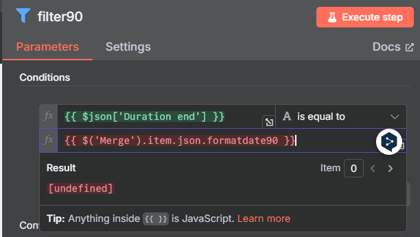

I tried with the Edit field (set) node but it also says 90 and 120 variables are undefined.
How to solve this?
Nevermind, I used the Aggregate node and it works now.
