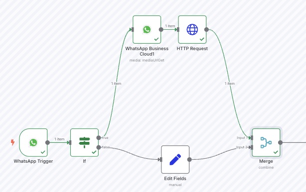

I’m working on a workflow triggered by Whatsapp chat. I’m using the IF node to create routes for message types: image and text. The routes will then end up in the same node, where their output will be used as input for an AI Agent.

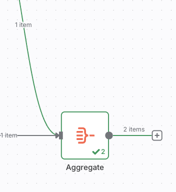

Basically, there’s no error, but I am expecting a different output. Here, it’s producing 2 items, while my expectation is only 1 item, which is like a merged output from those 2 items.
I’ve tried using Code node and so far the output is 2 items as well. I’ve tried Merge, but it doesn’t produce output at all.

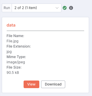

These are the outputs at the moment:

Hi,
Doesn’t merge by position not work?
Reg
J.
Hi @jcuypers .
I did try sending a text message, but no output there.
And after that I try an image, no output either.
This is my setup in Merge node.
Anyway, doesn’t it need both ouput from prev 2 nodes?
Update:
After setting up this option, it now works!
So, the solution is
