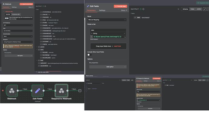

I’m trying to set up a webhook to verify the request Meta sends and then respond and confirm the operation.
Let me explain what I’m doing:
  1. Webhook (GET)
  2. Edit Field
  3. Respond to webhook

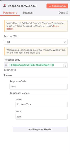

I’m sharing the various nodes so you can review them.
The problem is that from the Meta screen, I keep seeing the error saying that Meta was unable to validate the callback URL.
What am I doing wrong?
Thanks!
First of all you don’t need to use an Edit Fields node. You must set content-type response with the new update of n8n.
Thanks a lot!
Was a stupid problem, but in a lot of of topic i had read that the solution was with Edit Field, prob cuz was old topic!
I’m glad you got it working!
If you found my answer helpful, could you please mark it as the solution? That way, others facing the same problem will easily find the fix.
