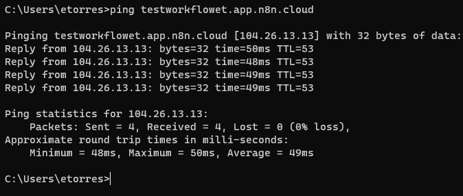

How do I know what are the n8n service IPs ?
With a ping to your cloud URL you can get it
Thank you, I try to see if the router is blocking that IP.
