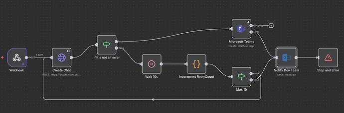

My thought when I read that comment was to just add a http node somewhere before the built in microsoft/teams node.
An alternative workaround I’m currently using - which does delay things, but is acceptable in my use cases - is to add a manual loop, with a wait of 10 seconds and loop a max of 10 times.
The ‘If’ node was needed because it was passing, but with an error. In this case, it checks {{ $json.error.message }}
Remember to adjust the nodes to read values from the webhook, not just the previous node. i.e. my Create Chat node takes an input {{ $(‘Webhook’).item.json.body.createChat }}

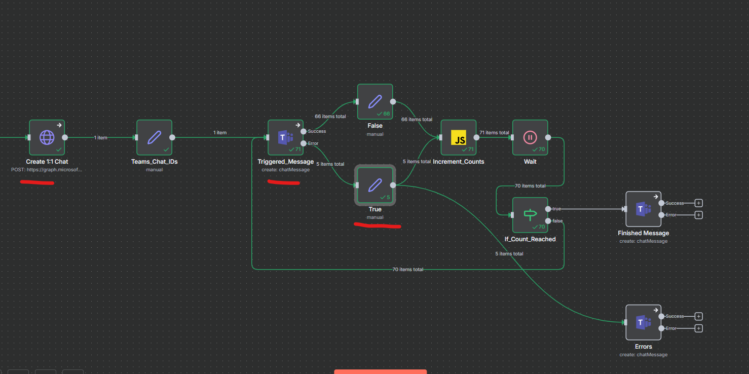

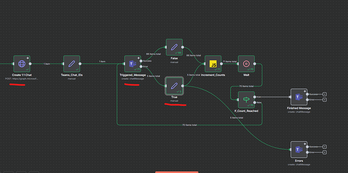

Ok so usually I would get the intermittent 403 errors on the native teams nodes version 2.0 as previously mentioned.
Recreating the issue - Approach 1
I updated to the latest stable Version 1.120.4 and ran a test where I loop sending messages from the same ID created via a custom HTTP call once to generate a 1:1 chat between my two teams accounts/users. Then using this chat ID to send messages via the native ‘Teams:CreateChatmessage’ node with a wait node of 1 minute between cycles.
I ran this every minute for 71 cycles/minutes until I triggered the 403 “No authorization information present on the request.” error for four cycles between cycle 58 to 61. The messages then resumed sending correctly after these 4 attempts and 4 minutes of outage for the remainder of the test.
Refreshing the 1:1 chat for each loop - Approach 2
Looping back to creating a new 1:1 chat via the HTTP post request. So every time I sent a message to the user I would first create a new “1:1” chat POST request and thus teams ID which with theory this might keep the token/chat ID valid for the following n8n native teams nodes where we seem to be getting the error:
Create 1:1 chat POST request
JSON Body:
“chatType”: “oneOnOne”,
“members”: [
“@odata.type”: “ microsoft.graph.aadUserConversationMember”,
“roles”: [“owner”],
“[email protected]”: “``https://graph.microsoft.com/v1.0/users``(‘{{ $node[‘BOT_Sender_ID’].json.botSenderId }}’)”
“roles”: [“owner”],
“[email protected]”: “``https://graph.microsoft.com/v1.0/users``(‘{{ $node[‘Target_User_ID’].json.targetUserId }}’)”
“members”: [
“roles”: [“owner”],
“roles”: [“owner”],
I tested this with 1 minute polling for 8 hours (480 cycles) with 29 errors of which 11 appear to be the dreaded 403 error and the others are “429 API calls quota exceeded!” in the following native n8n teams nodes.
Thoughts what it might be - Issue with the predefined credential auth?
So it seems to be an issue with how the n8n default predefined ‘Microsoft Teams OAuth2 API’ credential is linked and refreshes to Microsoft’s graph API whether it is any custom HTTP request or the n8n native teams nodes, the auth times out and takes a significant amount of time to come back online.
