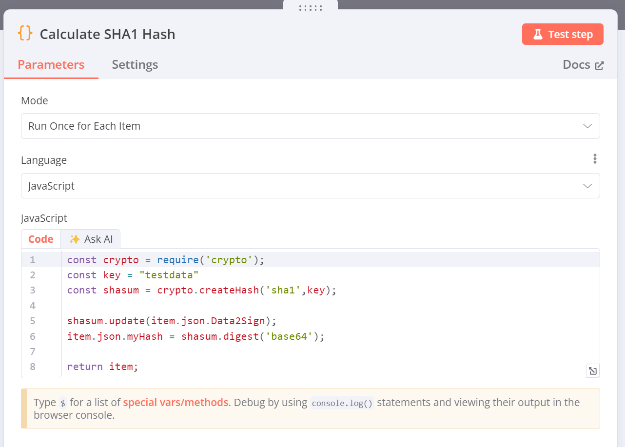

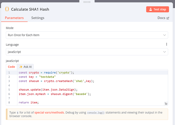

I can’t use the Crypto Node as no SHA1 support so have tried the below:
I have found some similar topics in the community as produced code, I notice however whatever I put in key doesn’t change the MyHash output. Assume I am doing something wrong, any help appreciated.

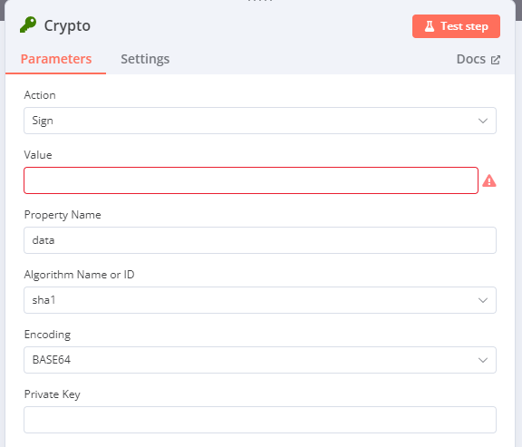

Seems like you want to sign something, for this we can use the Crypto node. When signing it does allow to use Sha1
Hope this helps :slight_smile:
I did consider this but would I then be providing base64 decoded Secret Key as they private key?

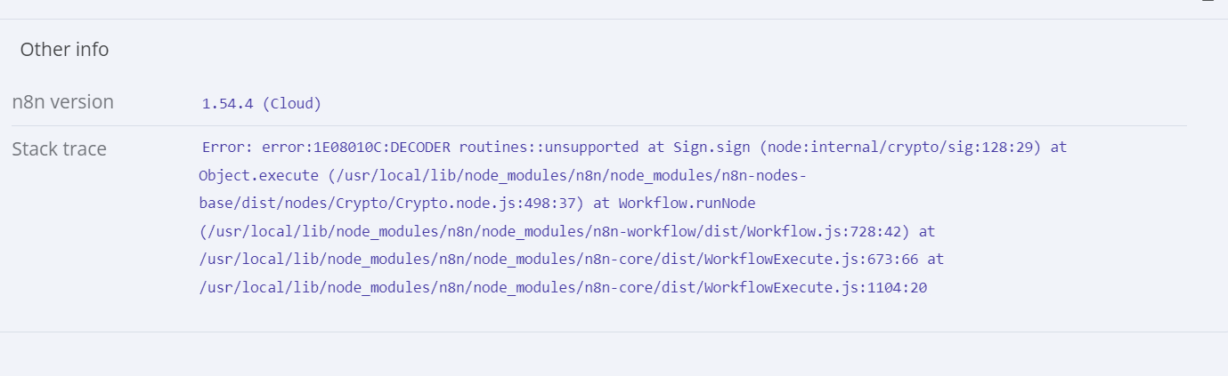

I tried and I get

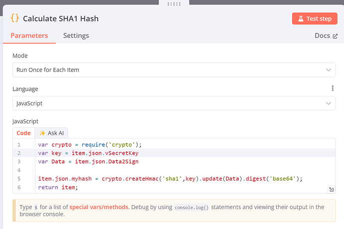

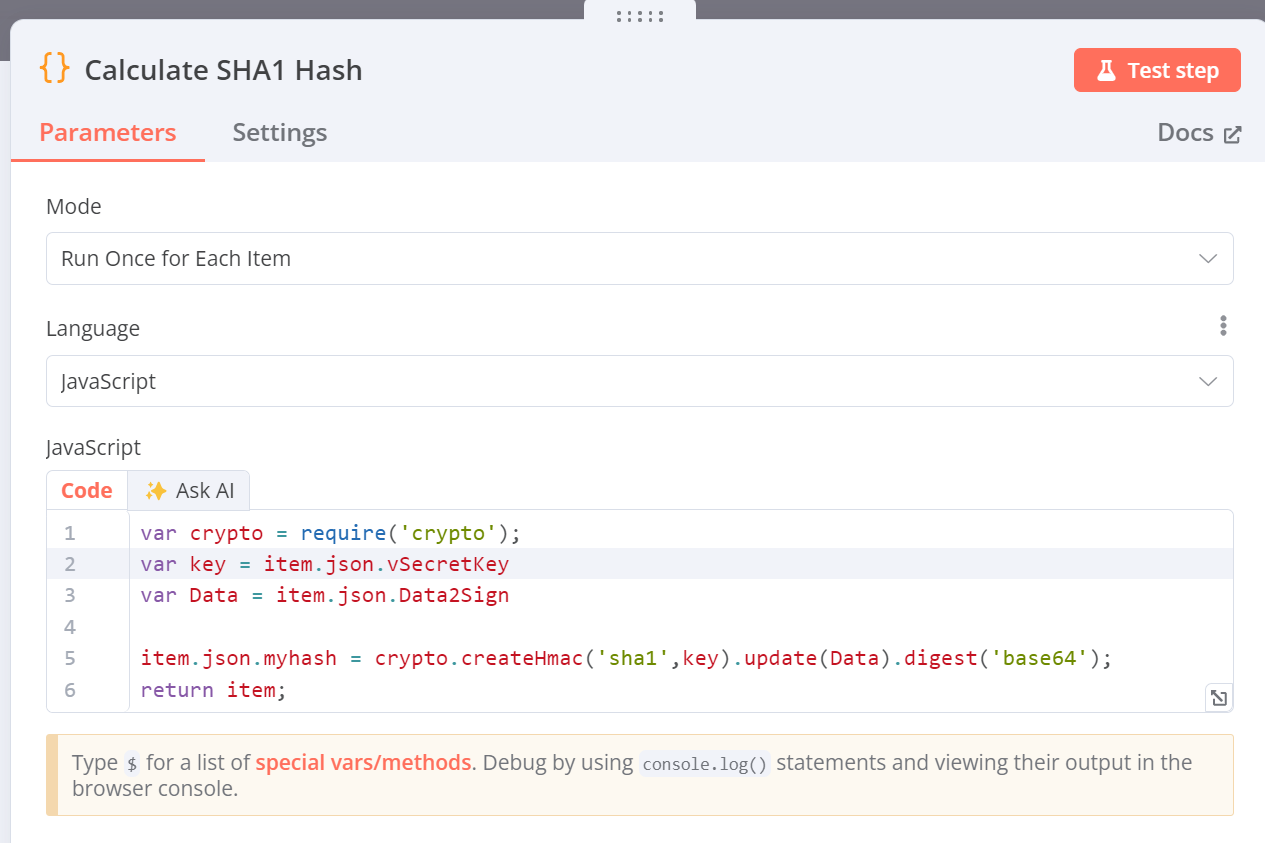

I have got to this point which I believe is correct, but I still get an invalid signature error back from the API.
An HMAC is different from a simple hash value. It is a way to calculate a signature for a message using a shared secret key.
You will need code along these lines (not tested in n8n as I don’t have example data):
function base64Decode(base64String) {
    return Uint8Array.from(atob(base64String), c => c.charCodeAt(0));
function createAuthorizationHeader({ uri, applicationKey, secretKey, accessKey, xMcDate, xMcReqId, realm }) {
    // Concatenate values to create Data To Sign
    const dataToSign = `${xMcDate}:${xMcReqId}:${uri}:${applicationKey}`;
    // Decode the base64 encoded secret key
    const decodedSecretKey = base64Decode(secretKey);
    // Create HMAC-SHA1 hash using the decoded secret key
    const hmac = crypto.createHmac('sha1', decodedSecretKey);
    // Update the HMAC with the Data To Sign
    hmac.update(dataToSign);
    // Base64 encode the result of the signed Data To Sign
    const signedDataToSign = hmac.digest('base64');
    // Create the Authorization header value
    const authorizationHeader = `${realm} ${accessKey}:${signedDataToSign}`;
    return authorizationHeader;
