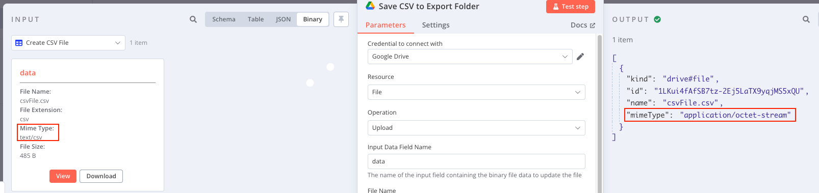

I am experiencing an issue with the Google Drive > File > Upload node in N8n.
When I upload a CSV file, which is converted from the previous node Convert to File > CSV, the mimeType is automatically changed from text/csv to application/octet-stream during the upload process.
This causes problems for the usage of the file, as it is no longer recognized as a CSV file in Google Drive.
While the file copy works perfectly, the only issue is the mimeType. As a result, when I click on the file in MyDrive, it does not open directly but forces a download to the local machine.
In the file details, it shows Type: Binary File instead of Type: Comma-separated values.
Here are the details of the workflow:
  • Node used: Google Drive > File > Upload
  • Expected mimeType: text/csv
  • mimeType after upload: application/octet-stream
Have you encountered this problem before, or do you know how to force the mimeType to remain as text/csv during the upload?

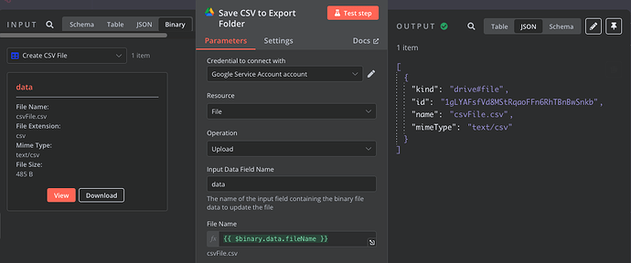

I ran your workflow (using your n8n version and the latest version locally) and encountered no such issue.
Thank you for testing the workflow.
I’m still facing the issue and not sure what else to check on my side. Could you suggest what I should look into to resolve the mimeType issue? Any advice would be appreciated!
Thanks again!
Hello,
I’m still facing the issue and not sure what else to check on my side. I’ve updated N8n to the latest version (1.61.0), but the mimeType still changes to application/octet-stream.
I continue to investigate the cause of the mimeType change. Could this be related to a configuration on the Google API side? I’ve looked into whether it’s possible to select mimeTypes during the upload, but haven’t found anything conclusive
Thanks again for your help!
I just tested with other formats, and I found that the issue occurs with *.xls files but not with *.xlsx files.
All three still work for me just fine, no changes to MIME type. I guess it is something on your Google Drive that applies changes. Not sure what else I can do.
