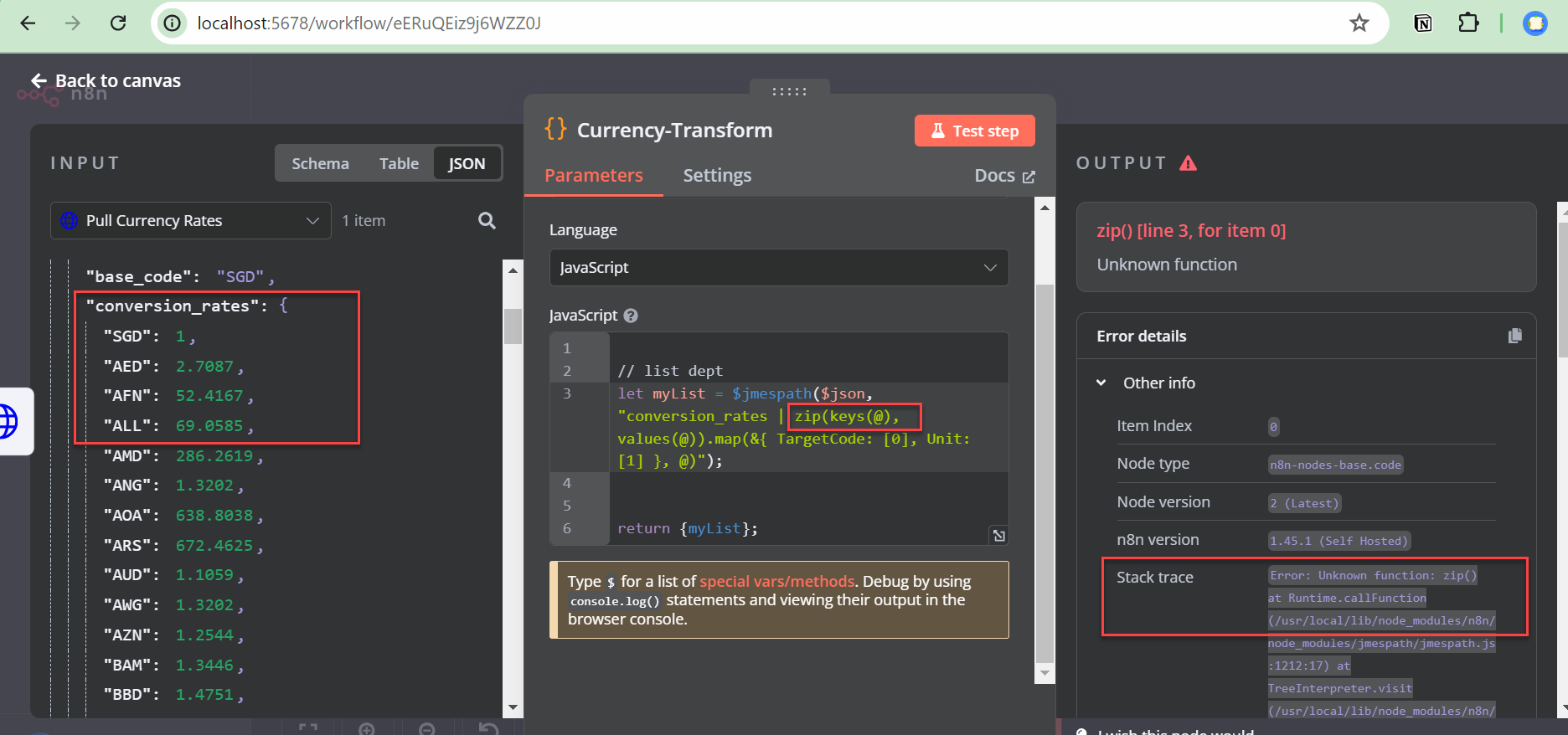

Missing "zip" function in JMESPath?
n8n spec
ver: 1.45.1
DB: SQLite
hosting: localhost/docker/window

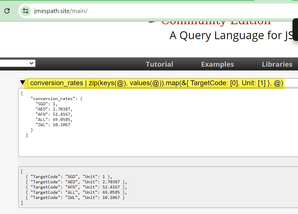

i have justified the JMESPath expression is working in their community site
But when i try to run in n8n Javascript block, it failed. Based on the log it seems like n8n’s JMESpath library doesn’t recognize “zip” method?
Hey @weilies_chok, thanks for reaching out! JMESPath does not define a zip method. Instead, here’s a resource for helping you get started with a zip method alternative in javascript. Zip arrays in JavaScript? - Stack Overflow

also, i noticed n8n doc point me to https://jmespath.org/, which some of the expression doesn’t work as expected. Later i moved on to JMESPath, using the same expression and it’s working.
So i bet the later site is more reliable/advanced?

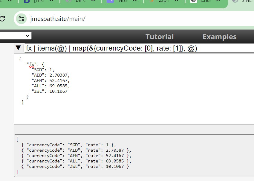

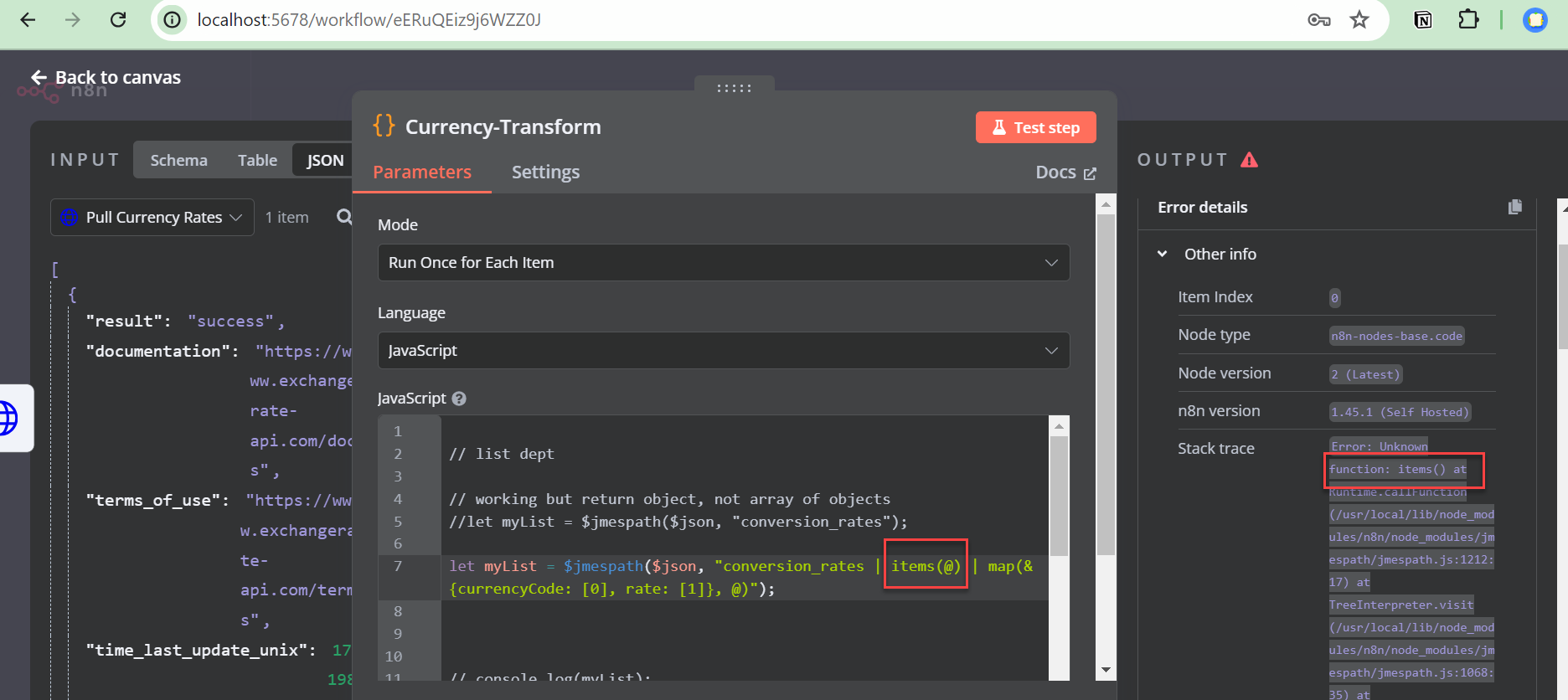

i tried “map”, but it hit issue as “items” is currently not supported
i tried in JMESpath community site, the expression is valid
may i know if i am planning to use expression, how to deal with it in n8n? (i know writting JS can simply achieve that but i want to make good use of JMESpath)
