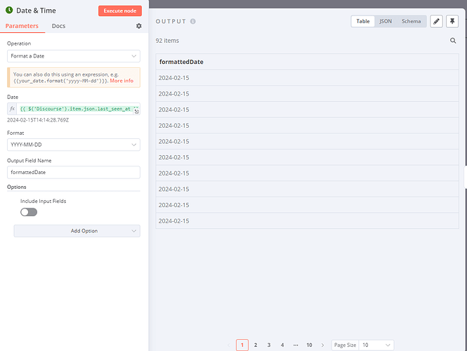

In what format is your date value? Monday expects in YYYY-MM-DD (1973-10-15),
The date-time formatter node just before the error node appends it to YYYY-MM-DD. Screenshot below:

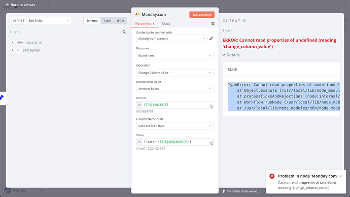

@Nejc_Lukacek I tried the exact same setup you did for “Change column value” using a simpler setup but ran into this ERROR: Cannot read properties of undefined (reading ‘change_column_value’)
TypeError: Cannot read properties of undefined (reading 'change_column_value')

@Nejc_Lukacek I’m so sorry about wasting your time. It looks like I was passing a discourse variable into a field that required a monday.com ID/variable, which is why it had a hard time getting a proper output for that node. Just got it to work!
Also, the formatting you suggested {“date”:“{{ $json.formattedDate }}”} was the one that finally worked. Thank you so much for your support <3 Really appreciate it
