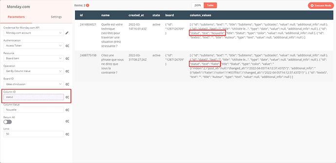

Hi @BramKn
Here’s a screenshot when I execute the node, you can see that the first item does not respect the filter but is returned.
Hi @Elliot
The Id of the column is without the capital S. Could you make sure to set the ID Exactly like the column ID? Hope this fixes it.
Also the value is shown as null and the Nouvelle is in the text field, not sure of that should be like that.
Hi @BramKn,
I’ve selected from the dropdown this name, all the columns name are available for selection when the board ID is recognized, should I bypass that selector and enter as an expression the ID ?
Hi @Elliot
Sorry, didn’t notice the dropdown. It should be fine if that is the dropdown option. But you can try.

Hi @BramKn
Thanks for your help, as an expression I still see inconsistent behavior :
It does work on some test filtering as I wish but on some other test it does not.
It’s very odd for me and I can’t seem to figure out why it happens.
