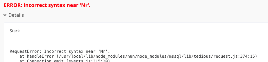

My second question revolves around using spaces in these column names. Since spaces are allowed in both the N8N json and the MSSQL column names I wanted to use them for longer column names. However, I keep gettiing “Incorrect syntax” errors:

I think the problem lies in a line of:
Line 284:
The columnString is used as “INSERT INTO ${table}(${columnString})”, which does not allow for spaces since here it is used as the name of a MS SQL column. It should probably be made safe by adding double quotes or square brackets.
Ok got fixed as well. Added it to the same PR that fixes the issue with the connection timeout.

Does this also mean that the column list is used both in the SQL statement INSERT INTO and in the selection of fields from the json in N8N? So that the column names have to be exactly the same between SQL and N8N?
Thanks in advance.
Yes, that is correct.
