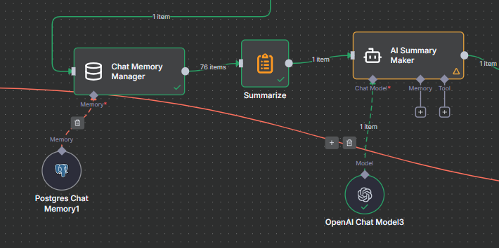

So I created the memory manager node,
Would I add it like this?
Would it do the same thing as adding a supabase Get many rows tool directly to the agent? If so are there any benefits of one method over the other?
TIA
i cant see the whole workflow logic but yes i think (also notice there are 2 branches in AI summary node, you will need a merge node), also as you mentioned in your case, you want to read the memory but not add to it.
So I think you need to add it somewhere after (agent 1), then configure it with the correct key mapping to get the messages you need, and then do your summarization (agent 2)
This way, you won’t add anything to Agent 1’s memory, you’re only reading from it..
So would it be something like this:
I used the summarize node so I could add a separator (commas) do I need to add a separator and if so is there a best one to use for the AI?
You can enable the Group Messages option to get a 1-item array for the messages:
Then use any AI node (such as Basic LLM Chain) to ask a model to summarize the messages:
The prompt would look something like this:
So the whole idea is that you’ve separated the memory from the first agent and the second agent.
In other words, there isn’t really a second agent, you’re just reading the memory from the first agent, then summarizing that messages, this process has nothing to do with the first agent itself..
I hope everything makes sense now..
