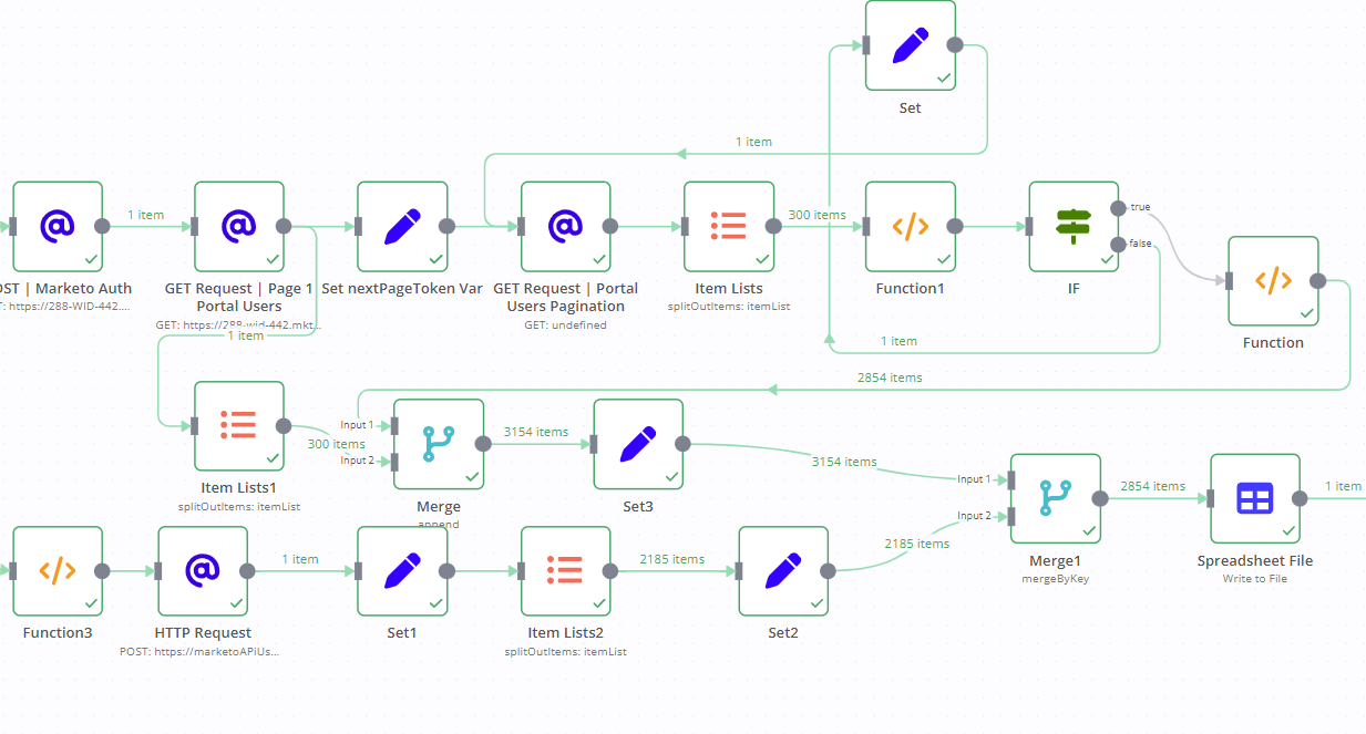

I think this is a quirk of the Google Drive API somehow. To reproduce the same behaviour I see from the spreadsheet node this slightly nuts setup will do it. Then I get my 1006 error.

I’m not sure tbh. Given the error references a header field in the csv (namely “email”), it seems like the file is being sent. Also, that was just using drive for example purposes, in fact I’m converting to csv from a workflow that pulls lead data from Marketo and Elasticsearch and reconciles on a specific ID. So I just have this data as items in the flow which I then write to a csv. I just uploaded the file to Drive as a way to share it.

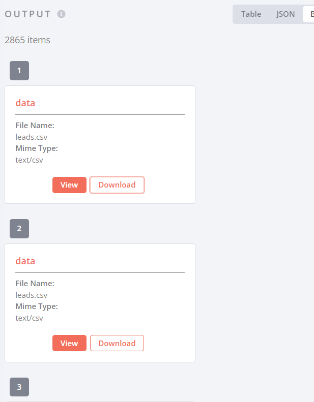

Okay but then I end up with a bunch of files like this:
And the format is like a row of split up json:
I can aggregate the data to get one file but then it’s one massive row with the format above.
Is there a way to create the binary file with the names as headers and the values as rows?
I think I might be confusing things with all my screenshots. At bottom what I need is csv formatted binary data without BOM. So comma delimited and carriage returns for new lines. The reason I used the spreadsheet node is that it quickly gave me that format. If I can do that with the Move Binary Data node that’s awesome but for now the resulting format might be a csv, but it isn’t placing my names and headers and my values as rows like the spreadsheet did so neatly. So then of course Marketo is unable to reconcile my data with the lead data table.
