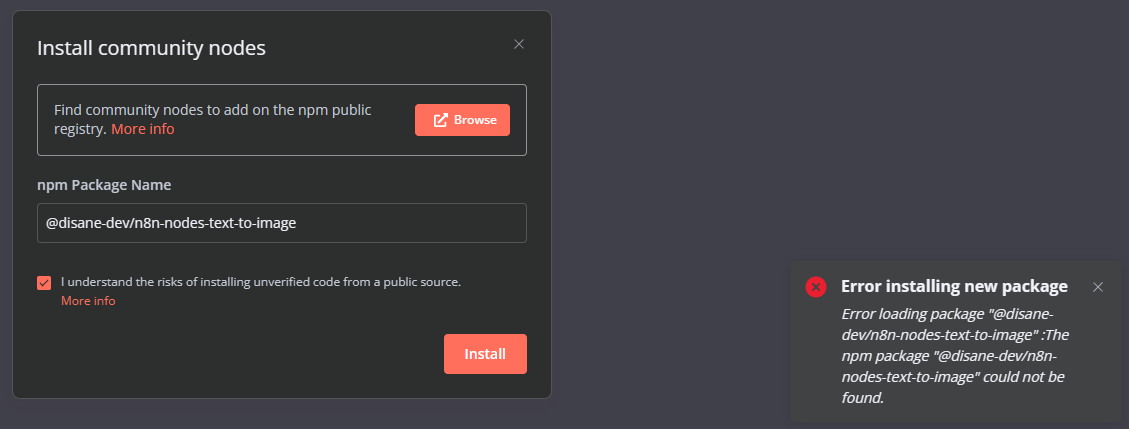

My custom node can't be installed
I’ve created a custom node which works pretty fine locally. Now I published it to npm and I want to install it on my production n8n but it states:
My n8n instance is running on UNRAID Docker. Other installations of custom nodes are working fine too.
IMHO the package is ok. Am I missing something?

Hey @Disane87,
Welcome to the community. :waving_hand:
For me it looks like your scope is named like
@disane
And not
@disane-dev
According to your package.json.
Please check that.
Cheers.

I’ve just activated the log and set the level to debug, but the message is not really helpful:
{"level":"error","message":"InternalServerError: Error loading package \"@disane-dev/n8n-nodes-text-to-image\" :The npm package \"@disane-dev/n8n-nodes-text-to-image\" could not be found.","metadata":{"file":"LoggerProxy.js","function":"exports.error","timestamp":"2023-11-12T17:44:08.135Z"}}
