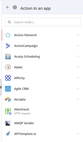

I created an n8n node three months ago and published it on npmjs. However, the node still doesn’t appear in the n8n actions menu. Could someone please help me figure out what’s going wrong? Is there any additional step I need to take to make the node show up in the menu?
My node: n8n-nodes-aivoov - npm
I want my node to be visible here.

I successfully installed the node on my local Docker environment, and it also appears in the actions menu of n8n at http://localhost:5678/.
Now, I need this custom node to be available in the live workflow environment at https://aivoov.app.n8n.cloud/. How can I achieve that?
Hi,
Well that’s going to be a hard one, since cloud instances don’t support custom nodes. …
I assumed since you developed a node you would be self-hosted or at least know the limitation.
Anyway they are working on adding some community nodes to the official ones but I don’t know how this will work out.
Your only option for now if self-hosting.
