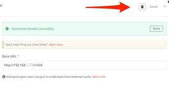

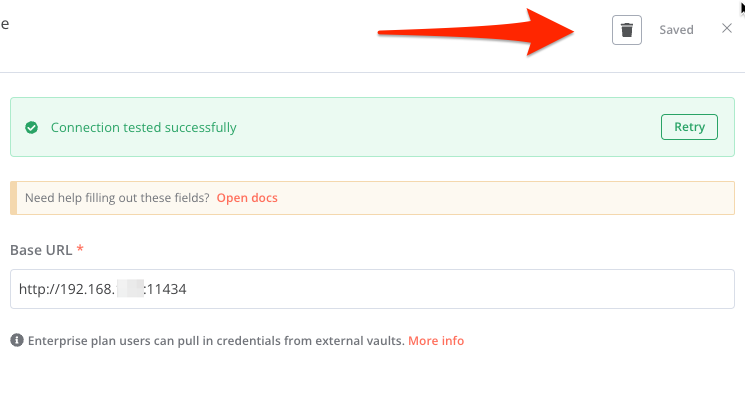

I noticed that the BASE URL of Ollama (set in the Credentials tab) keeps returning to the default value which is not the right value for me.
I’m guessing it should be saved in a DB or file but it seems that it’s not…
I’m running n8n in a docker on a dedicated machine, using self-hosted-ai-starter-kit and my Ollama runs on another local machine.
The docker CAN connect to the Ollama server but as soon as I configure the URL in the credentials, it doesn’t stick.

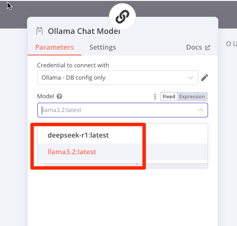

  1. Your environment is using read-only credentials (e.g. predefined via env or Docker
So in order to overcome this and the previous bullet point, I created a new Credential for the same Ollama server - this config persists after a restart (saved only in DB and not in a file). As can be seen below, the couple of models I’m hosting locally are identified.
What’s next?
So I managed to have persistent Ollama credentials for my workflow (even though I only bypassed the problem, and haven’t really solved it).

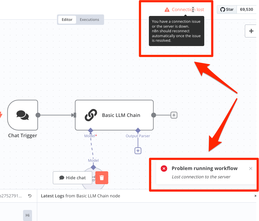

The UI still shows the following error messages:
I’m asking myself what is this server I lost connection with. If it’s not Ollama, is it n8n itself?
What is the proper way to debug this message?

Hi @Zohar
You’re spot on suspecting both the reverse proxy and the “server lost connection” message — that’s a classic WebSocket disconnection issue, and yes, it refers to n8n, not Ollama.
Here’s how to debug and improve your setup.
What “Lost Connection” Actually Means
That message usually shows up in the UI when the WebSocket connection between your browser and n8n server is lost, often due to:
A misconfigured NGINX reverse proxy
WebSocket traffic not being upgraded correctly
Timeout or low memory (esp. on 512MB droplets)
