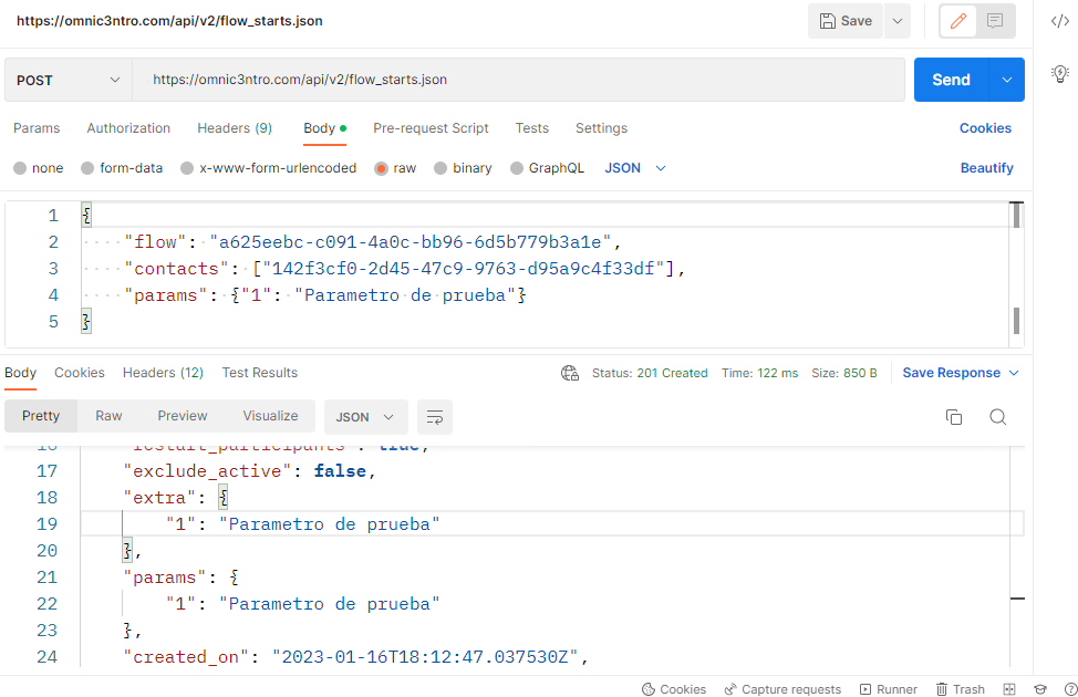

Here show an example, on postman, the fiel appear like
"params": {
    "1": "Parametro de prueba"
