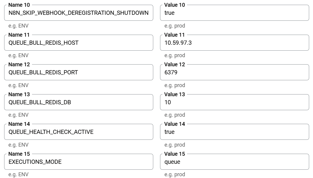

Since I don’t have a workflow I’ll be sharing the most relevant settings for both instances.
Main:
4 GB and 4 vCPUs
Fixed to 1 instance
Worker:
2 GB and 2 vCPUs
Min. 1 instance, Max. 100 instances

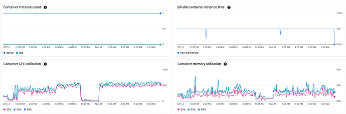

My worker recent metrics:
This is from the last 24h, where the queue got completely stuck and the worker refused to go beyond a single instance.

This is just a wild guess, but Google Cloud Run targets 60% utilization to scale up, and you have 2 vCPUs allocated for each worker container. If that is presented to the container as 2 separate cores, and the n8n process (node.js) doesn’t ever use more than 1 (node.js is single threaded), maybe you’re never going over 50% and never triggering the autoscaling.
Just as an experiment, you could see what happens if you allocate only 1 vCPU per container.
It really worked! I didn’t try but I imagine that putting the concurrency limit higher would also lead to a similar effect, because I connected the Redis DB to a Bullboard instance and my queue seemed to be always stuck at 10 jobs a time. Maybe that’s why it was never going over the processing threshold.
