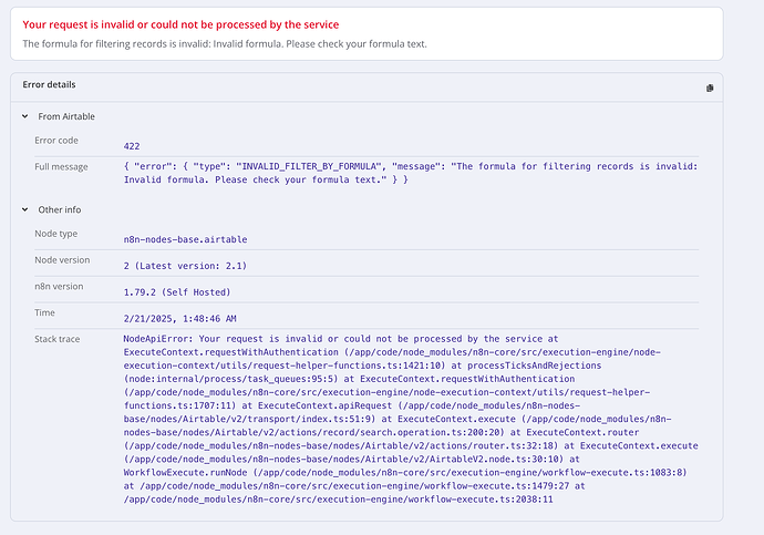

Thisis the output because the airtable formula doesn’t work because the variables are [undefined] but i use these variables in many subsequent nodes so those would error too.

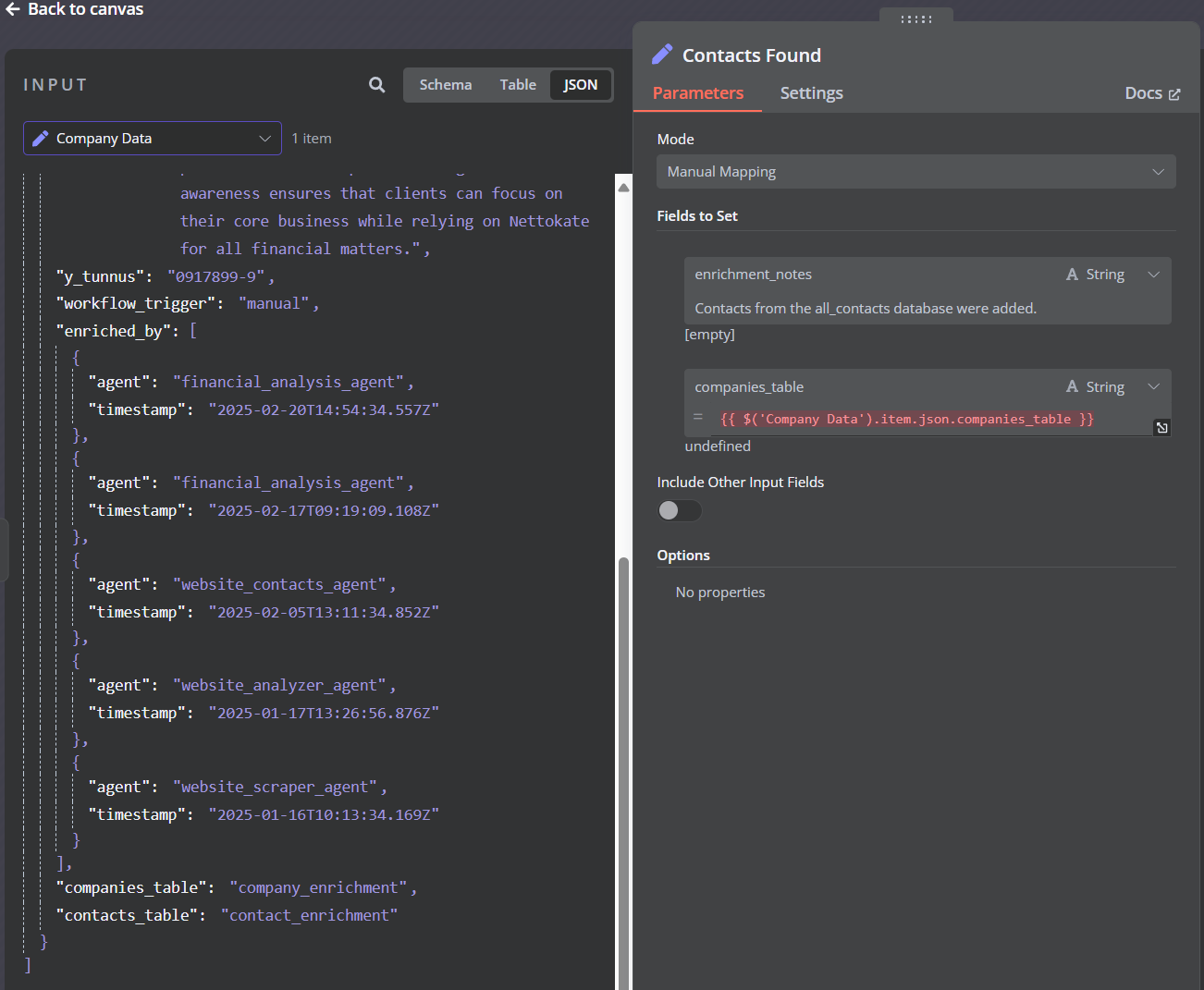

I tried copying the workflow above but did not run into the error. Would you happen to have another example? Maybe @Tero could you share your example?
Thanks for the quick replies guys!
  • I am running the latest could version 1.79.3.
  • Sorry, I can’t get the workflow below the character limit without completely breaking it so can’t paste it here. Here is a download link to the workflow from the video (add a set node after the Postgres node and reference Company Data node to replicate): database_contacts_agent____.json
  • Here is a quick recording how it looks: After postgres node can’t access previous nodes.mp4
    (Edit: changed video share settings to anyone)
That mp4 is not public… If it’s < 5MB you can just drag it into the message editor to upload it here.
Sorry about that, should be public now.
Can you update to 1.79.4 or 1.80.3 either of these 2 versions will fix this issue.
Confirmed: Updating to 1.80.3 fixed the issue!

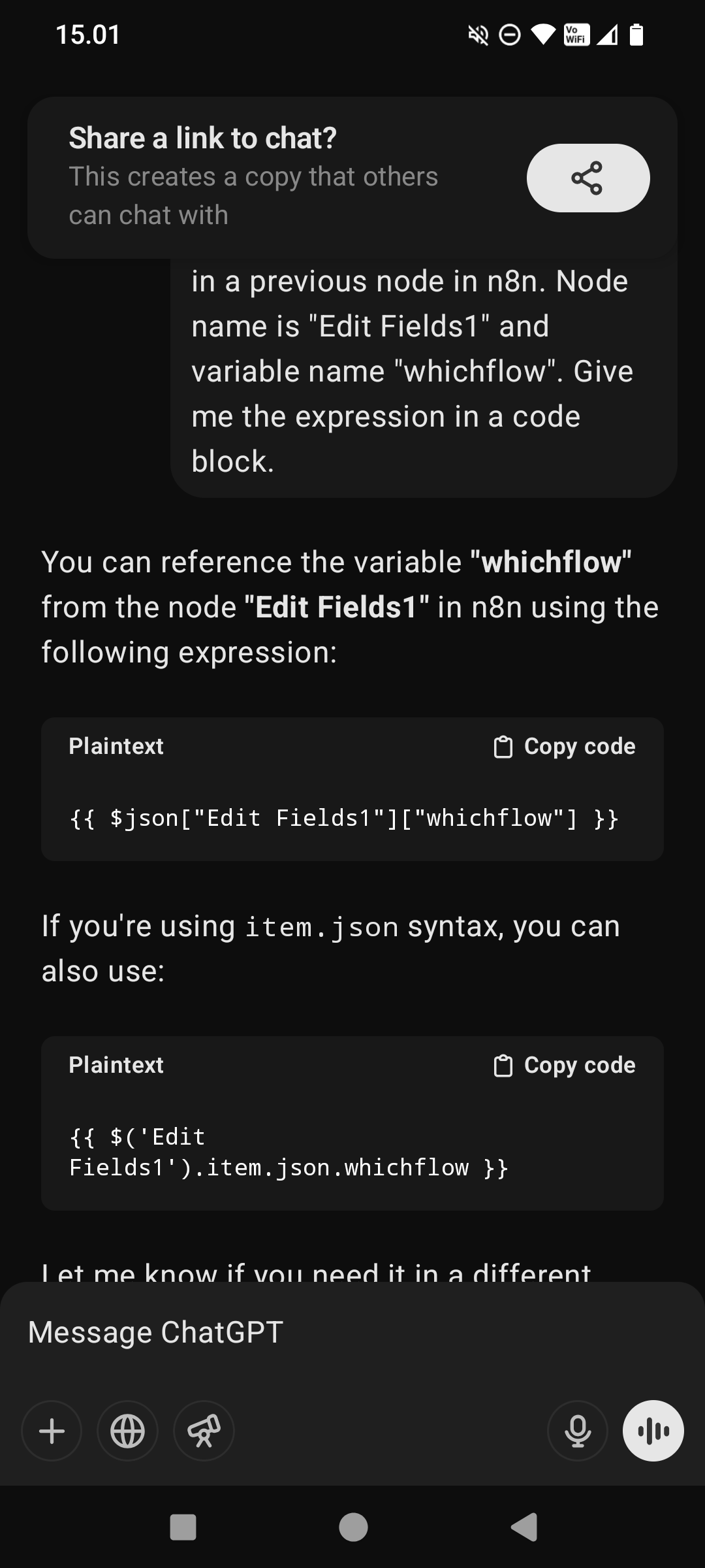

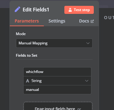

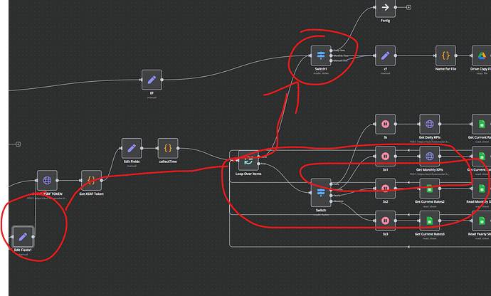

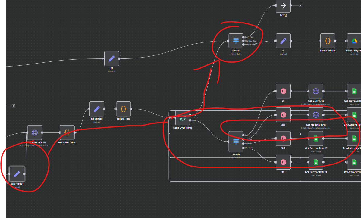

How do I reference a variable that I set with edit fields and later want to check again. I want to access that variable in a switch fields event. Nio way to access my $json.whichflow cause it wasn’t passed… how do I pass global variables that I want to access across the entire workflow? Is this so hard… like wtf?
{{ $('Edit Fields1').item.json.whichflow }}
