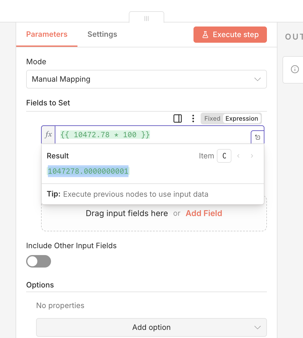

Hey,
Can someone exmplain me how this works?
{{ 10472.78 * 100 }} i get 1047278.0000000001

Hey Guys,
i understand how 01 binary works, and thank you for the solutions, i already using round math.
i just dont understand why in set node you are not using simple math, but js :slight_smile: for me its the same if i would do this in excel and get 1047278.0000000001 :slight_smile:
thank you all
@ConstantineK
Because the Set node uses expressions, and in n8n expressions are JavaScript-based. So even for simple math, the expected approach is to use a JS expression like {{ $json.a + $json.b }}. If the logic gets more complex, that’s usually when I’d move it to a Code node.
Yes exactly that’s a great way to handle it.
Since n8n expressions use standard JavaScript, floating point precision can cause those small decimal issues, so using Math.round() is the safest approach for clean results.
Your example works perfectly:
{{ Math.round(10472.78 * 100) }}
This ensures you always get a proper integer without unexpected decimals.
