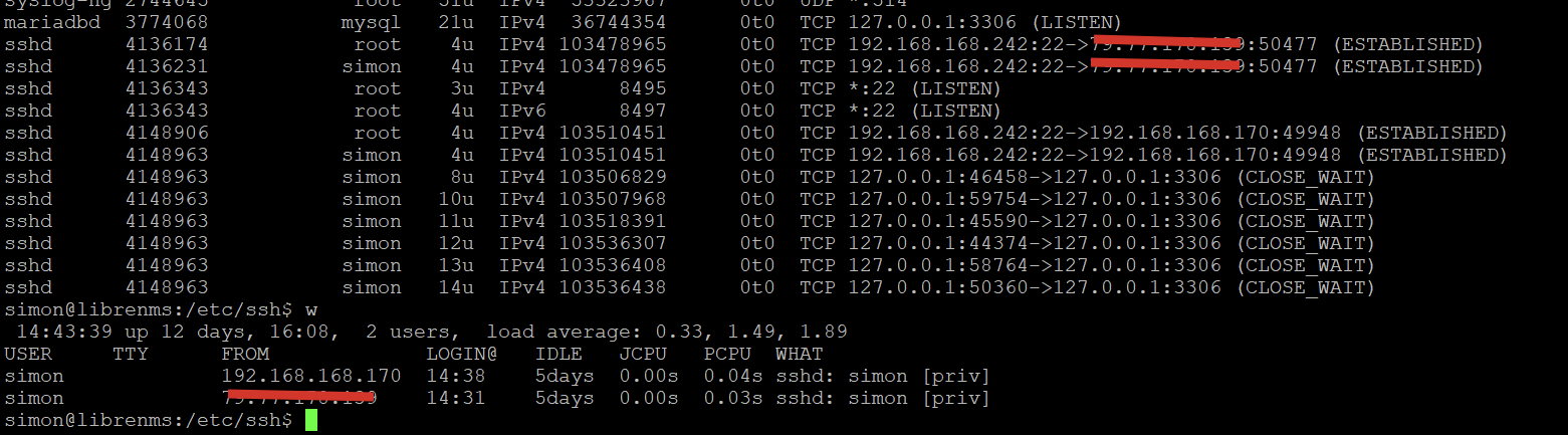

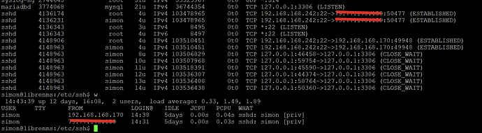

(see attached pic .170 is my n8n, .242 is my mariadb on my librenms server)
it seems to open an ssh session and keep it open as expected
(unless its suppose to close the ssh after its been run)
but when it runs the mysql query and finishes, its not closing the connection afterwards?
also spotted if i deactivate my workflow, the ssh session is still active and doesnt close the connection?
