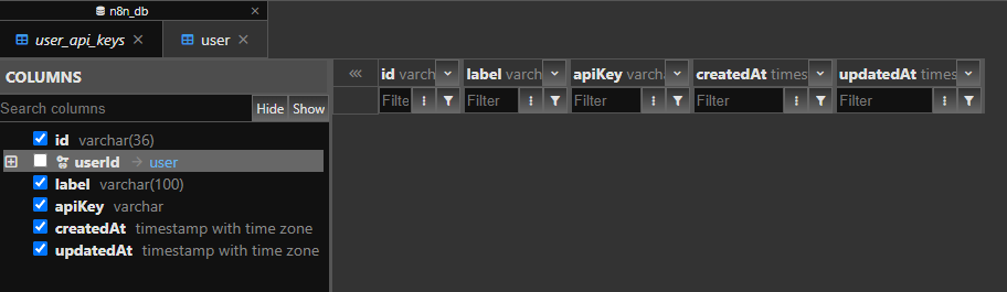

Okay, I think I found the root cause of the issue. (CC: @netroy)
I’m not exactly sure what happened under the hood, but in my case, the column was found in the user_api_keys root, and the label was n8n
So the first thing that came to mind was that it might be related to the n8n API credentials.
I deleted that specific credential, and surprisingly, the upgrade and migration were successful!
So basically, just delete the n8n account API from the credentials and give it a try.
