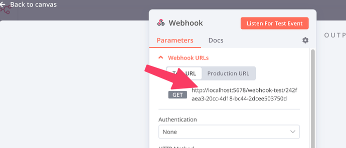

I think this not working because even if this start still showing localhost on webhooks
Also this should be updated in documentation because there is old info about tunnel.

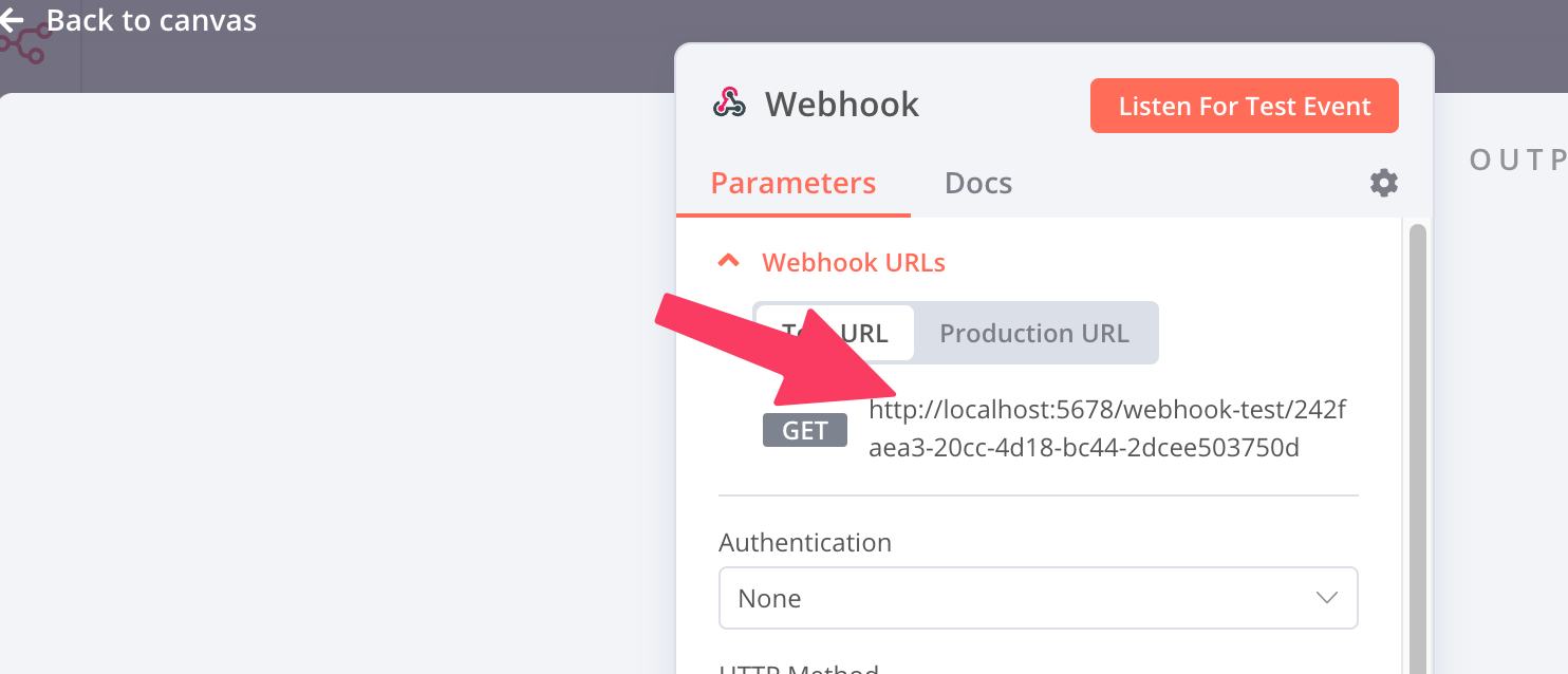

But also is problem because even i start on my localhost with tunnel
sudo docker run -d -u root --restart unless-stopped --name n8n -p 5678:5678 -v ~/.n8n:/home/node/.n8n n8nio/n8n start --tunnel
There is in webhook localhost
I’m using raspberry pi in my localhost, everything working fine only tunnel not, there is no error when i run -d flag in docker. also use 1.0.5 v
