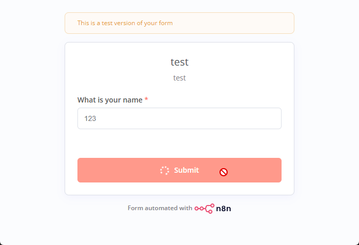

Checking if anyone else is experiencing the same issue. I’m hosting n8n with a postgre container and a cloudflared container using Docker in the same Docker bridge network.
The Form trigger was working previously on n8n 2.0.2 version.
After I upgraded the n8n instance to 2.1.0+, the Form trigger is not working when i remotely execute it. When you click the submit button, it will keep spinning, but nothing happens.
I use cloudflared as a tunnel so I can remotely access my n8n instance.
And I’ve added the following environment variable - WEBHOOK_URL=’https://n8n.example.com’
So the Form URL looks correct. It just looks like it’s not receiving any input submission.
If I downgrade the n8n instance back to 2.0.2, it will work again.
Just a simple On form submission trigger node.
