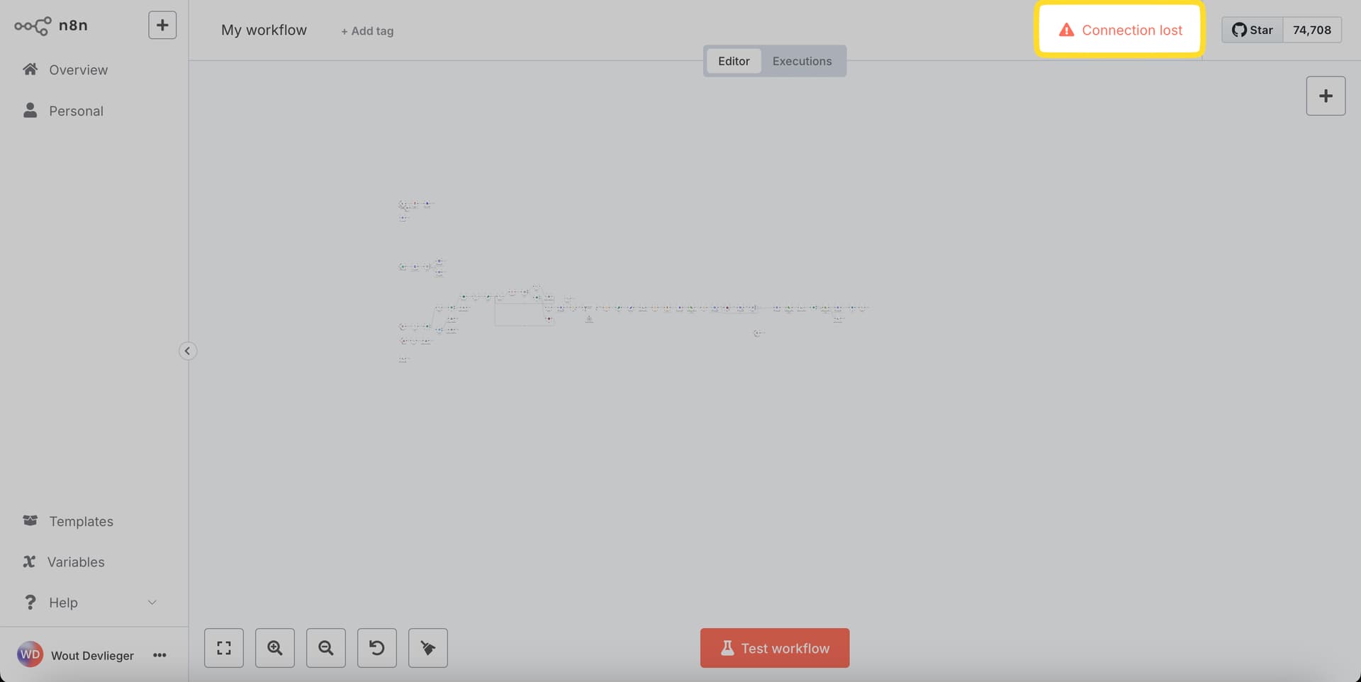

Hi everyone,
I recently set up n8n on an Ubuntu server and configured it to run as a systemd service. The instance is reachable via my custom domain (e.g. https://n8n-roasted.kaffie.co), but when I open the page, I keep seeing a “Connection lost” message at the top. The UI loads, but it seems like the frontend can’t maintain a stable connection with the backend.

  • In the browser, the n8n UI loads fine at https://n8n-roasted.kaffie.co, but the “Connection lost” warning stays visible at the top.

Hi @Floreal_Animatie,
I had the same Issue regarding connection lost.
I’m running n8n also as a service, but with apache2 as proxy installed.
As long, as I had no WebSocket Rewrite in my site file, there was the same behavior like yours.
This site config works fine now:

    RewriteEngine On
    RewriteCond %{HTTP:Upgrade} websocket [NC]
    RewriteCond %{HTTP:Connection} upgrade [NC]
    RewriteRule ^/(.*) ws://127.0.0.1:5678/$1 [P,L]

Thank you this works for me on Apache2 :saluting_face:
