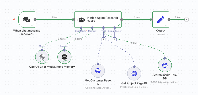

My body for Http request: get project page ID:
“filter”: {
“property”: “Projektname”,
“rich_text”: {
“contains”: “{{ $json.project }}”

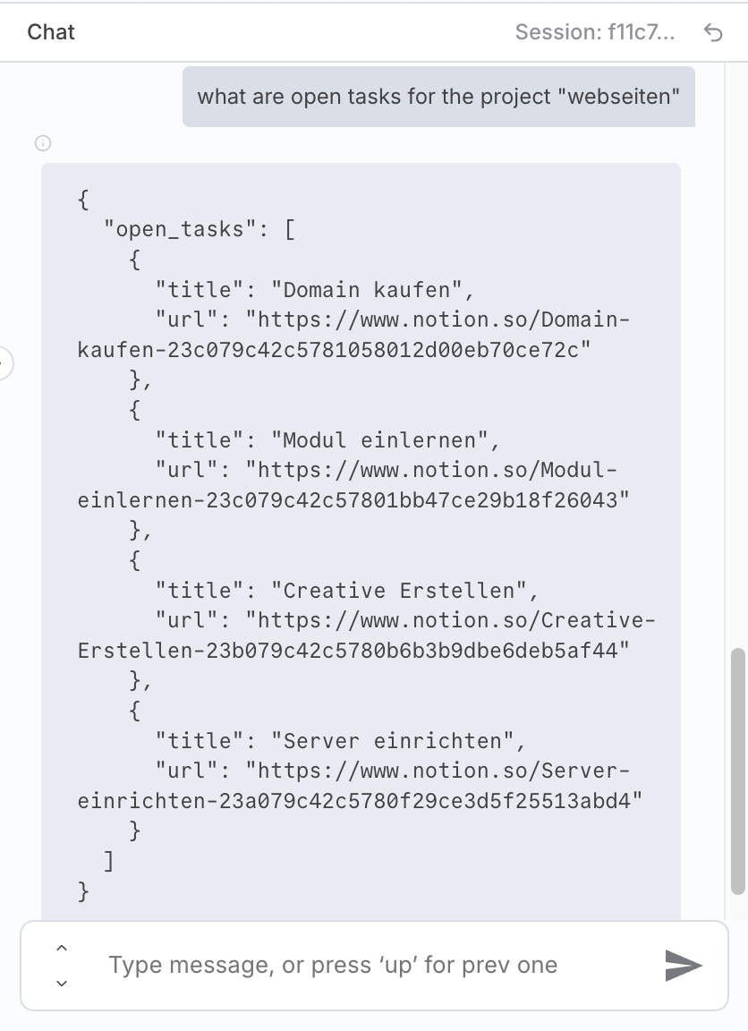

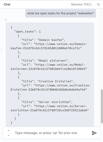

it is working that it shows me the open tasks of the database:
but the problem is that it is not applying the filter for search and the input is empty for “get project page id”

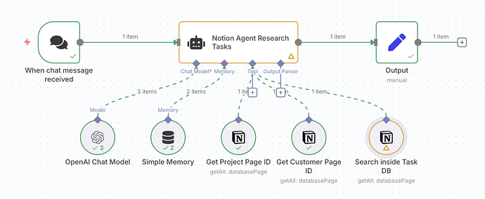

This is my take on the task:

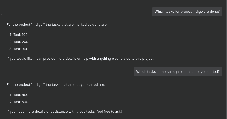

Here is our chat:

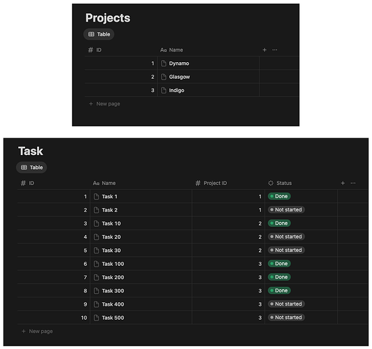

Here is the database:

Here is my workflow:
My filters:
When only one input is delivered (it appears an error):

the way to build a dynamic filter which takes zero or no filters would be either to teach AI agent to make JSON filters from natural language by explaining what operations are, what the format is, and how to combine them etc OR to get all records and explain the logic of filtering to the ai agent, like I did in my example - in natural language. The first is more bullet proof, but requires a good explanation of the filtering logic, the second is much easier to implement, but needs to pass more text to the model (read more tokens). Which one you prefer is for you to decide.
