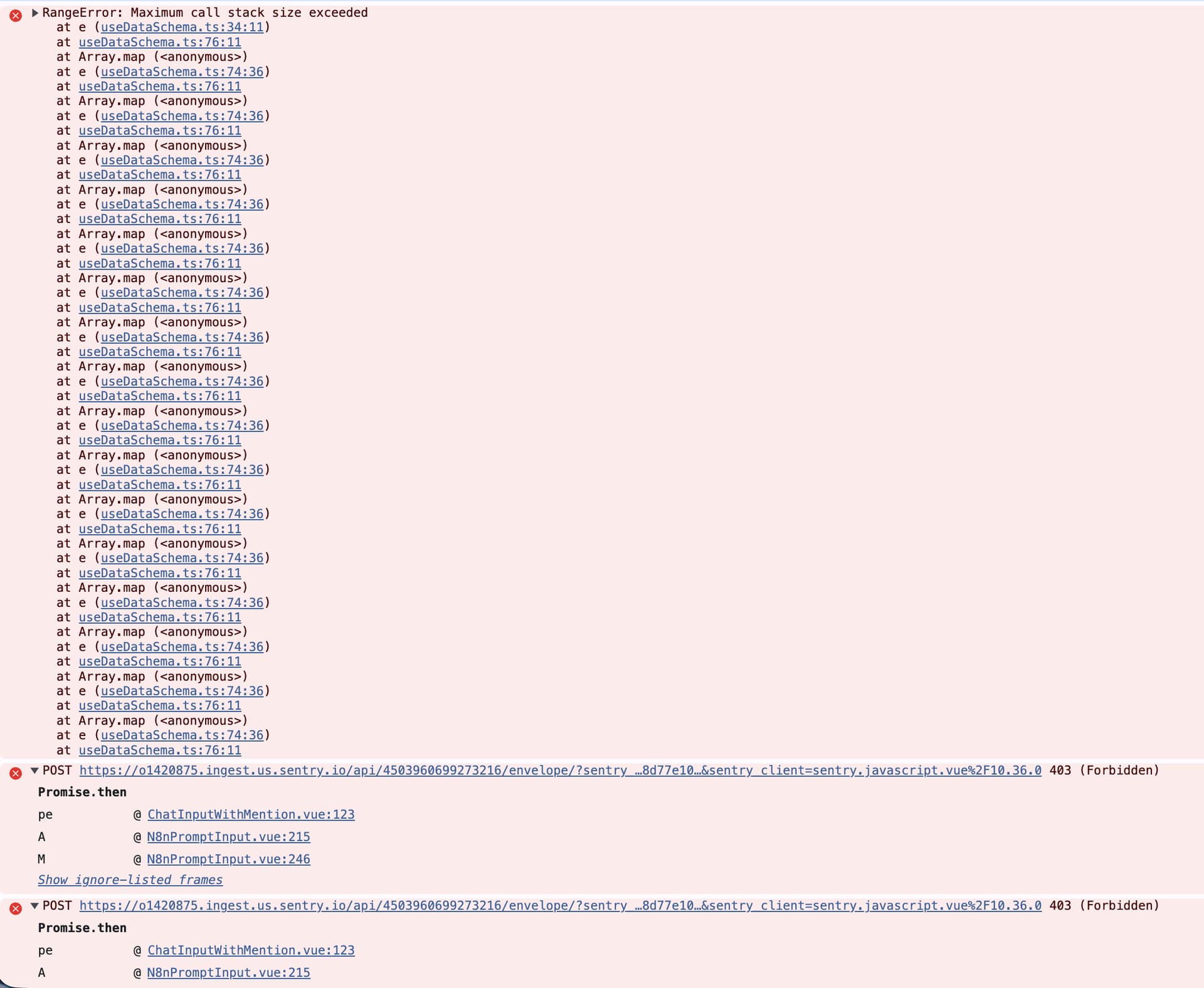

I couldn’t find an exact GitHub issue for this, so I think it would be worth opening one.
Since you’re on n8n Cloud 2.15.0 and already tested the usual browser-side fixes, this looks specific enough to report, especially with the Maximum call stack size exceeded console error.
If possible, I’d also include a minimal reproduction: the shortest prompt sequence that works once and then consistently gets the assistant stuck. That usually makes it much easier for the team to verify and debug.
@hefty Hi
The loop is happening inside a file called useDataSchema.ts.
When you ask the AI a question, it tries to read the structure of the data flowing through your workflow, so it can give you an accurate answer.
If your workflow has a very deeply nested JSON object, a massive amount of data, or a circular reference in one of the node outputs, the schema reader gets trapped in a loop trying to map it all out. Once it crashes, the AI is left “thinking” forever because the background process died.
The 403 (Forbidden) Sentry errors at the bottom just mean n8n’s system is trying to send an automated bug report about the crash to their developers, but it’s getting blocked.
Before asking the AI a question, try clearing the execution data in your nodes, or test the AI on a blank workflow. If it works on a blank workflow, it confirms the AI is choking on the specific data structure of your current workflow.
