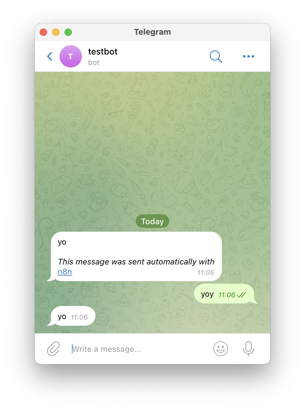

Hey, I just tried replicating this on 1.82.1, but couldn’t. For me, the send message operation worked the same with or without n8n attribution. And this is definitely not something related to trial or non-trial users.
Basic workflow example (can you maybe share yours or a simple example to try to debug?)
