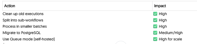

Here’s a table and documents that can help you:
Overview | n8n Docs
